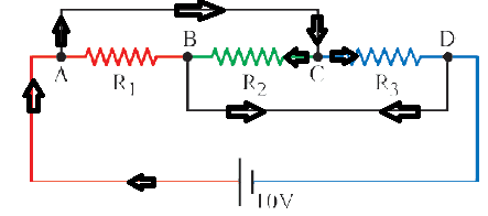

I want to know the current direction in the circuit. From where to where it will flow.

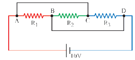

I know the simplification of the circuit. All the three resistor will be in parallel. But without simplification of circuit. I want to know the direction of current.
You have enough posts to know better than to ask others to do you work for you. Try it yourself and if you get stuck, come back for help.
I have tried out. But don't know this is right or wrong.
Below the label "R2" you have a current flowing to the right. Below the label "R3" you have a current flowing to the left. These currents are flowing in the same wire. You need to rethink that.
Here. No current is flowing through resistor R1.

If the resistors are all in parallel, as you correctly pointed out they are, how is it possible to have a voltage that drives a current through 2 of the 3 parallel resistors but causes no current to flow in the other?
Again, you need to rethink things.
One thing I would suggest is that you get rid of the duplicate labels. I think they are misleading you into somehow thinking that they do not represent the same nodes in the circuit.

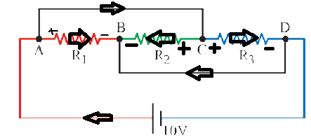

Label on each resistor which terminal is positive (connected to the positive terminal of the battery) and which is negative. The current will flow from + to - through the resistor. Then apply the Node Rule to decide the currents through the shorts.

I have tried but what to do next, i am confusing.

You know the voltage at each end of R1, so you should be able to find the size and direction of the current across that resistor as well.

But I have tried to redraw the circuit (by removing the labelled :smile:) and i have solved it.

Draw the currents through the resistor R1 first. Its terminal A is connected to the positive pole of the battery. The other terminal is negative. So the current flowing through it is from ... to ... .
If you know the current through R1, apply the Nodal Law at B, and you get the direction of current through the wire connecting B and D. The other arrows are all right in your figure in Post #13. ehild

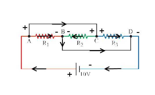

Now, finally i got this. That i want.
Thanks.
Here, all three currents
1) flowing through A to B
2) flowing through C to B
3) flowing through D to B
are meeting at junction B. from B it is not going to negative terminal. But Point B has negative polarity to left and right side of it.
SO it is ok.
No. At junction B, current flows in both from A and C. So the current must flow outward through the wire connecting B and [STRIKE]C[/STRIKE] D. Change the direction of the arrow.
At D, there are ttwo currents flowing in, both through R3 and through the wire BD. So the third current should flow outward, through the wire joining to the negative terminal of the battery.

I'm going to break the rules and just post the solution as the OP has made several attempts...
