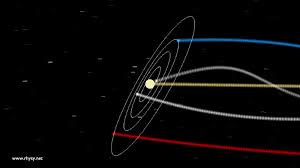

Somewhere there is a reasonably good youtube animation showing Earth's corkscrew trajectory around the galaxy...
I will be looking out for that. The joys of random questions that come to us early in the a.m. [emoji6]
russ_watters said:
Somewhere there is a reasonably good youtube animation showing Earth corkscrew ingredients around the galaxy...
Actually, I'd advise against looking for that, without first steeling oneself against crackpottery. The most popular one I know of is 1. somewhat inaccurate, 2. loaded with nonsense annotations (paraphrasing: see Earth does not circle around the sun, but rather it's a 'vortex'! therefore scientific cabal; ivory tower; we're being lied to; etc.).

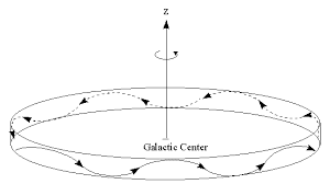

- if we looked at this elongated, bent helix from afar, it'd be just a line. This line has to bend around the galactic centre to form a circle. The radius of curvature is so large, however, that it would not be noticeable at the scale where you can resolve the helix.
- additionally, it needs to follow a sinusoidal path perpendicular to the plane of rotation (plane of the galaxy). This is due to peculiar motion in the plane-normal direction taking it slightly above the disc, where mass in the disc pulls it back, and the Sun overshoots in the opposite direction, moving below the disc. And so on. I don't remember the estimated frequency of those oscillations, but it's probably on the order of a dozen per orbit. Again, only really noticeable when you zoom out from the helix.
The two above look like this:
(the picture has the +z axis pointing towards the galactic south)

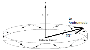

3. Adding to that motion of the Milky Way w/r to the Local Group of galaxies - this means mostly just the hurtling towards the Andromeda galaxy.
This changes the wobbly, elliptical orbit around the galactic centre into another leaning, helical one. This one looks very squashed, since MW moves towards Andromeda almost edge-on, with inclination of only 20°
The distance between bends of this helix is approx 3 times its radius. It's much more tightly wound than the previous one.

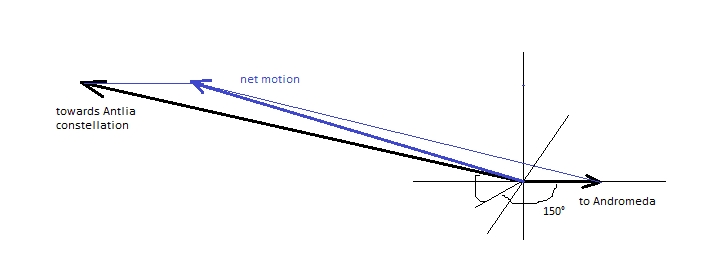

4. Finally, add the motion of the Local Group w/r to the CMBR-rest frame. This is pretty much a straight line in the direction of the Pump (Antlia) constellation.
This changes direction of the last helix like so (rather crudely eyeballed and drawn, I know, but mostly preserves proportions):
You need to imagine the already twisted helix from 3 as going towards Andromeda changing direction towards the 'net motion' one. Think of it, again, as a slinky toy with one end at the origin, and the other being dragged from the one arrow to the other. The trick is to preserve the angle of the bends as you do so.
So this step makes the helix from 3 more elongated and twisted in yet another way.
