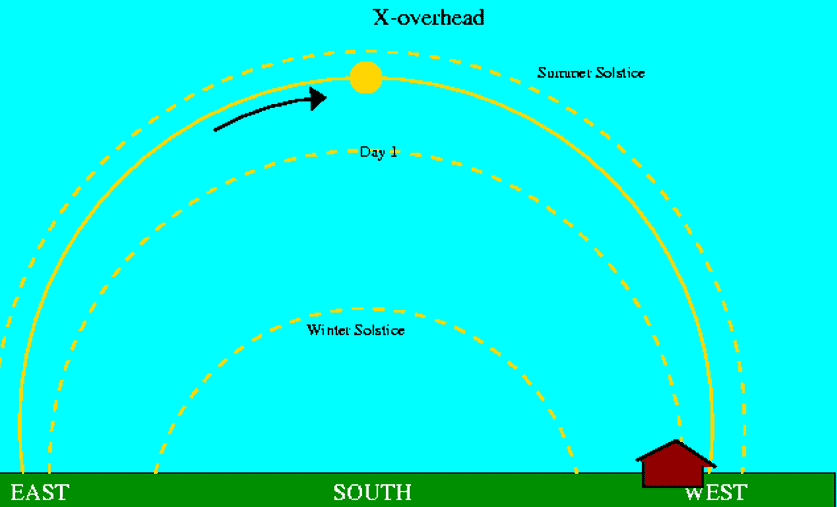

When first introduced to the concept of the ecliptic, I was under the impression that the ecliptic was the path taken by the Sun across the sky over the course of a day. That is to say, the rising in the east and setting in the west, due to the Earth's (daily) rotation from west to east. (Image below).

Is the daily movement of the Sun the portion of the ecliptic we see on that day? Am I describing two different movements?
I would be grateful if someone could explain/clear this up for me.

No, the daily motion of the sun across the sky is not the ecliptic. Note that the stars also rise and set, so the daily motion of the sun relative to the stars is very small. If you could see the sun and the stars at the same time (you can't, because the sun is too bright), you would see them move together across the sky. This is a consequence of the Earth's daily rotation. The ecliptic is the sun's path through the stars over the course of the year, which is a consequence of the Earth moving in its orbit around the sun. It is also the plane of the Earth's orbit projected onto the celestial sphere. These are two ways of saying the same thing. Because the other planets and the moon have orbital planes which are close to being in the same plane as the Earth's orbit, the moon and planets stay near the ecliptic as they move thorugh the sky, but not exactly on it.
