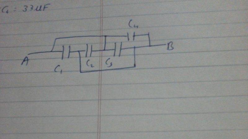

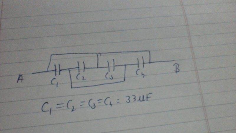

Here's the question as it was given.
Handwritten circuit diagram of four capacitors C1 to C4 between terminals A and B, with overlapping wires looping above and below them; below it is written C1 = C2 = C3 = C4 = 33 uF.
we should find the effective capacitance across A and B,
##C_p = C_1 +C_2+...##
##\frac{1}{C_s} = \frac{1}{C_1} +\frac{1}{C_2} +...##
Looking at the diagram i thought The capacitance should be zero.. shouldn't it be zero?
because there is a wire directly connecting A and B.
but the answer was given as 132 µF, that would happen if the 4 capacitors were in parallel, like this maybe
Handwritten circuit diagram of four capacitors C1 to C4 between terminals A and B, with wires bypassing some capacitors. Label at top reads C4 = 33 uF.
then yes it should be 132µF.
i still think that the answer to the original question is zero, could someone verify or correct me.

Your first circuit is a short circuit so has no capacitance. The second one is 123uF.
NascentOxygen said:
one is 123uF.
You mean 132 µF
Thank you, just needed to be sure.:)
