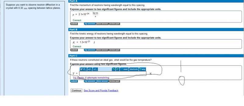

see attachment.
I've asked this question before but no one replied. not sure what formula I should use.
already tried lambda (max and med) = C*m*K but neither of them worked.
I need some help with this pretty quick if anyone can, thanks.
I think you should use the equipartition theorem.
3/2 k x T= K
(Where K is the kinetic energy and k is the Boltzmann constant)
That worked.
Thanks for the quick reply!
