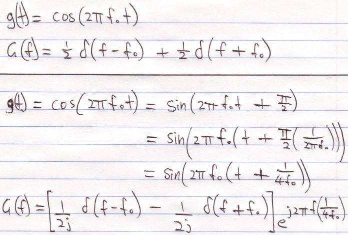

Hi, I tried to work out the FT of cos(theta), and sin(theta + pi/2) which should both give the exact same FT since they are the same function.
However I get two different results as shown in the .jpg.
I used the 'time shifting' property to get that exponential in the second part.
Thanks in advance

Multiply the exponential factor through and use the fact that [itex]\delta(f-f_0) h(f) = \delta(f-f_0) h(f_0)[/itex].

I managed to work it out to almost the same as the cos function FT, however I am still left with the minus sign before the 2nd delta function, how do you get rid of that?
Check your signs. One factor will be just j and the other one will be -j, which conveniently flips the sign of that term.

Yes you are right. I forgot to sub in f=-f0 for the 2nd exponential.
It works out perfectly.
