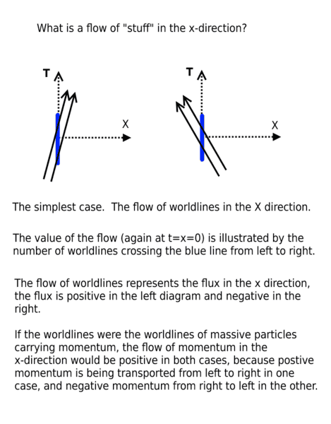

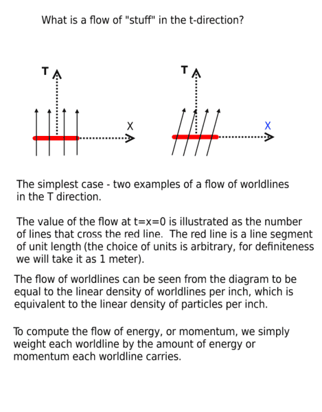

This looks like a good spot to post a few of the diagrams I've been working on:
I am drawing 2-d space-time diagrams for a 2-d ideal gas, made up of collisionless particles. You can think of the diagram as one line per particle, or a scaled diagram as one line per n particles. A real gas would have velocities in random directions, but one can "group" the flows of the same velocity into a sub-diagram, compute the contribution of the sub-diagram to the total flow, then add all the sub-flows together to get the total flow.

This ideal gas has a 2-d stress energy tensor, with 4 components:
##T^{00}## the flow of energy in the t-direction, ##T^{01}##, the flow of energy in the x-direction, ## T^{10}##, the flow of momentum in the t-directoin, and ## T^{11}##, the flow of momentum in the x direciton.One can add collisions into gas without much difficulty if they happen at a point, but getting into that would be a needless distraction at this point.
Each particle can be assumed to carry some momentum and energy along its worldine.
Let's start with the flow of "stuff" in the t direction:
As you'll see the "rate" of flow in the t direction is the amount of stuff normalized to a unit length, not a unit time. So the flows in the t-direction are spatial densities - they aren't rates. To address an objection previously raised.
"Stuff" is deliberately vague. It could be the flow of worldlines themselves (which makes up the number-flux 4-vector)
For more on the number-flux 4-vector see http://web.mit.edu/edbert/GR/gr2b.pdf
The flow of "stuff" can also be the flow of energy and momentum, which is what we need for the stress-energy tensor. Each particle in the diagram is assumed to have a certain momentum and energy, to get the flow of energy you multiply the flow of worldlines by the energy per woldline, to get the flow of momentum y ou multiply the flow of worldlines by the momentum per worldline.
Next up - flows in the "x" direction.
When you do a Lorentz transform, the relevant quantities are the flow of "stuff" in the t' direction, and the x' direction. These directions are not the same as the t and x direction. So you have to transform the flows. Additionally, if you are computing flows of energy and momentum for the stress-energy tensor, you need to transform the energy and momentum relativistically, as well as the flows.
I had another diagram that illustrated how to transform the flows, but it appears to have fallen victim to a power outage. Basically, though, if you know the flows in the t and x directions, a linear combination of the two will give you the flows in the t' and x' directions, as long as your flows are conserved flows.
