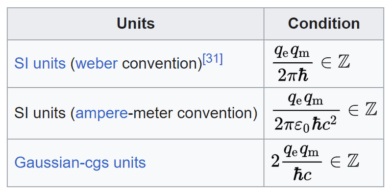

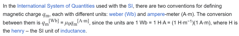

This is all well-trodden ground. From https://en.wikipedia.org/wiki/Magnetic_monopole:
Note that in 1931 Dirac proved that if monopoles exist, both the fundamental electric charge ##q_e## and magnetic charge ##q_m## must be quantized such that their (suitably normalized) product is an integer:
And using these formulae, or indeed the generalized Maxwell equations above them, it's easy to show that, depending on your choice of convention, magnetic charge carries units of webers or ampere-meters:
