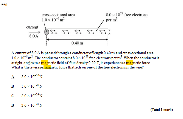

question - see image
Physics exam question diagram: a conductor of length 0.40 m with cross-sectional area 1.0 × 10⁻⁶ m² carries a current of 8.0 A, with 8.0 × 10²⁸ free electrons per m³; multiple-choice options A to D listed below.
so I use the equation F = BIl
F = 0.2 * 0.4 * 8 = 0.64
Surely I just divide it by the number of electrons (8*1028) to get the answer
BUT this does not give the correct answer.
The correct answer is D?

Ah. That's not the number of free electrons, that's the density of free electrons.
so density / area = number/m
right?
right?
##\rho = \frac{n}{volume}##
If you calculate the volume of the wire you can find the total n.
so n = density * volume
n = 8 * 1028 * 0.4 * 10-6
therefore answer = D
