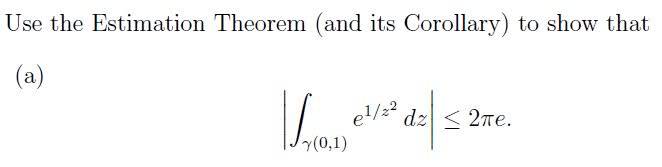

What is the maximum of the function f(z)= e1/z2 in the unit circle?

So the length of the contour is L(gamma) = 2.pi
and so i have http://images.planetmath.org:8080/cache/objects/7138/js/img1.png
so i need to show max f(z) = e?
So the maximum of f(z)= e1/z2 in the unit circle centre 0, radius 1 implies that 1/z2 should be maximum, and this is when z2 is its lowest possible value.
When this happens f(z) cannot equal e unless the lowest possible value of z is 1, but isn't that the highest possible value?
Any help would be great thanks

On the unit circle z = exp(i theta). So you need to find an upper limit for
|exp[exp(-2 i theta)]|
Hint: Split the inner exponential in its imaginary and real parts.
so exp[cos(2t) - i.sin(2t)]
i have an example similar to this stage where i.sin(t) suddenly disappears, so I assume it does that here as well. Could you explain why for me please?
And then the upper bound of cos(2t) = 1 and so the result follows.
exp[cos(2t) - i.sin(2t)] = exp[cos(2t)] exp[- i.sin(2t)]
And then when you take the absolute value, you use that
|exp(i p)| = 1 for real p.
ah i didn't know that, thanks
