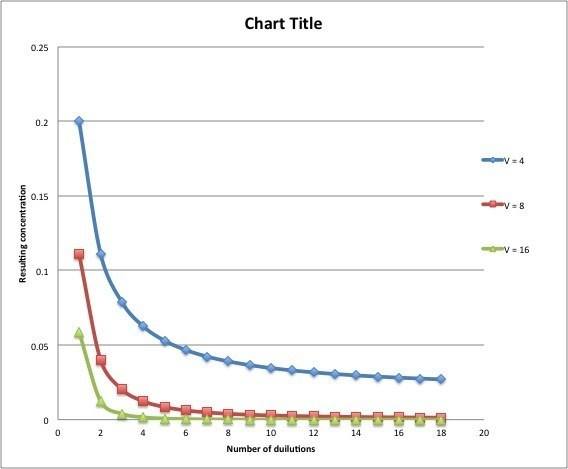

There's a bit of Maths needed here, I think. For the simple case of dilution of volume 1 of paint in the brush when you have volume V of thinners.
You have so much solvent and divide it into n equal portions of V/n
The first mixing / cleaning will dilute the paint by
1/(1+V/n)
You then pour away all but the volume 1, that remains in the brush
After n mixings you have a dilution of
(1/(1+V/n))n
I plotted some results from Excel for V = 4,8,16 and for a range of n
I hadn't realized but, even when you have a small amount of solvent, it seems that you can do far better with multiple dilutions. The the smaller the amount of mixture left in the the brush, of course, the better use you make of the solvent.
You just pried open door that is frequently used by every chemist in the world. This approach is a basis of the liquid-liquid extraction technique.
You live and learn - Excel strikes again. I'd never have been bothered to do it by hand and I'm too rusty to be doing it 'by algebra'.
In the limit with V large, the optimal dilution should be by a factor of 1/e at each cycle.
http://en.wikipedia.org/wiki/Radix_economy
I suppose e has to rear its ugly head in a situation like this.
What I found more interesting is that, even if you only have an equal amount of solvent, you can get significantly better dilution by using, say ten dilutions, just adding 1/10 of the solvent you've got each time.- i.e 38% concentration instead of 50%. If you just have 4 times the volume of solvent, you can get a concentration of only 3% with 12 dilutions. Actually, this does agree with my experience of cleaning brushes and just splashing small amounts of thinner on them but doing it several times.
My conclusion here was incorrect. If you take the cost of a factor of n dilution as n then the assumptions of radix economy would apply and the optimum would be a dilution by a factor of e each time.
But if you, more reasonably, take the cost of a factor of n dilution as n-1 then the optimum is to add as little solvent as you can manage at each cycle. This corresponds to "continous compounding". This fits with Sophiecentaur's observations.
