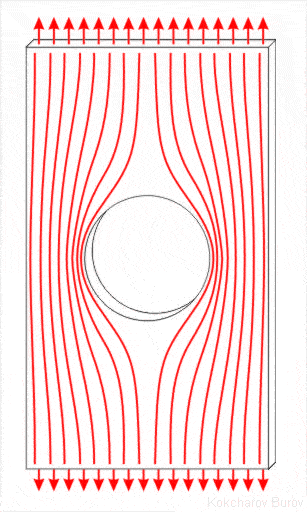

Force lines method is used in Solid Mechanics for visualization of internal forces in a deformed body. A force line represents graphically the internal force acting within a body across imaginary internal surfaces. The force lines show the maximal internal forces and their directions.
But stress in a solid body is a tensor not a single vector. What is the relationship between force lines and the stress tensor field? If I know the force lines can I calculate the stress tensor field? If I know the stress tensor field can I calculate the force lines?
Force lines in a rectangular plate under uniaxial tension, shown as red arrowed curves running vertically, bending around a circular hole in the centre of the plate.

Unless the body is in hydrostatic equilibrium or is experiencing a purely volumetric change, the principal stresses and their directions can always be determined at each spatial location (i.e., the principal stresses are determined solely by the deviatoric stress tensor). Tracing out the directions of the principal stresses is what you might mean by the force lines.

As best as I can understand from your article, the "force lines" are loci created by identifying the maximum principal stress direction at given location, extending a small segment of it to a neighboring location, and then determining the maximum principal stress at that location. In that way a continuous locus of maximum principal stress directions can be traced out.
