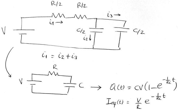

I have the following circuit
What is the relation between $$I_{eq}~~and~~ i_1, i_2, i_3$$?
Kirchhoff Laws
See the image above

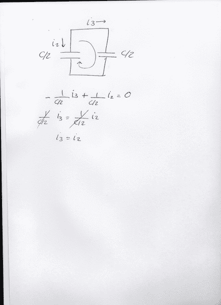

You have correctly found that i1=i2+i3. What can you say about the relative size of i2 and i3?
I think they are equal
They are, but do you know the reason why?
Yes:
OK great. You have found the relations between i1, i2 and i3. All that remains is how Ieq. fits in the picture. Any ideas?
I would say it's the same as i1 because it's the same current that flows through the resistors.
Correct. It looks like you are done.
