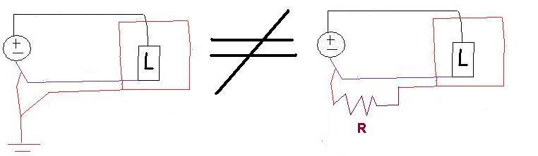

I made a quick diagram if u can help me,
attached
can u give me an example of how a ground would be connected
The ground would be a separate wire from the -ve terminal of the supply to the metal case of the equipement.
At the negative terminal it would also be connected to the Earth (in the real world through a buried metal rod).
The load might be enclosed in a metal case, and the ground wire connected to that case. Somewhere else in the house, the ground wire and neutral are connected together (perhaps near the "source" in your diagram) and also (as mgb_phys mentioned in post #6) "usually connected to a copper rod into the ground or a cold water pipe."
Normally, the ground wire and metal case are not part of the circuit. But if the wiring inside the box becomes loose and touches the metal walls, that completes the circuit. Lots of current flows, trips the circuit breaker or fuse, resulting in no voltage being applied to the device.
It's a safety feature. Without that ground circuit, if the wiring in the box gets loose and touches the metal case, there is no complete circuit ... until somebody comes along and touches the box (which is in contact with the live wire) and electrocutes themself.
Edit added: just saw mgb_phys's figure. A picture is worth a thousand words!

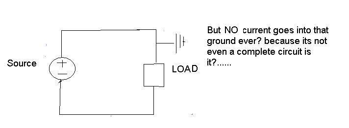

so when exactly then will current go into this ground wire?
like if there is too much current? but if there is too much current flowing into the load how does it know to start flowing in the ground wire? Wouldnt the current try to pick the least resistive path and as a result continue to travel through the load?

Only if there is a fault in the equiepment and the live wire touches the metal case.
A light bulb isn't a good example since there isn't ussually anything metal to connect the ground wire to. Modern light fittings often have a screw terminal in the plastic base to connect the ground wire to. This is completely pointless but is needed to meet wiring codes - this might be what is confusing you!
If you look inside a metal desk lamp or a toaster you will see a green/yellow (at least in europe) wire connected to the case.

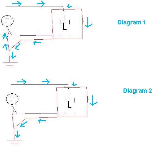

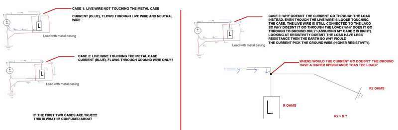

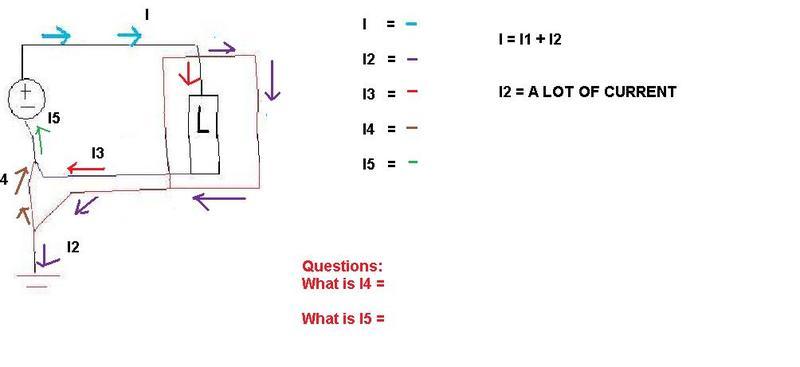

No, the fuse is there to blow if there is to much current. The Earth wire is needed to blow the fuse.
As Redbelly said, suppose there was no Earth and the live wire came loose and touched the case. There would be no path for the current and so the fuse wouldn't blow - but if you come along and touch the metal case the current can flow through you (bad!). The Earth wire is there so that if the live does touch the case it will flow down the Earth wire - this short circuit will pull a lot of current and blow the fuse.
there is less resitance directly down the Earth wire than through the load. The load must have some resistance to do work. The Earth wire is designed to have much lower resistance.
edit - don't know why the picture doesn't show up properly.

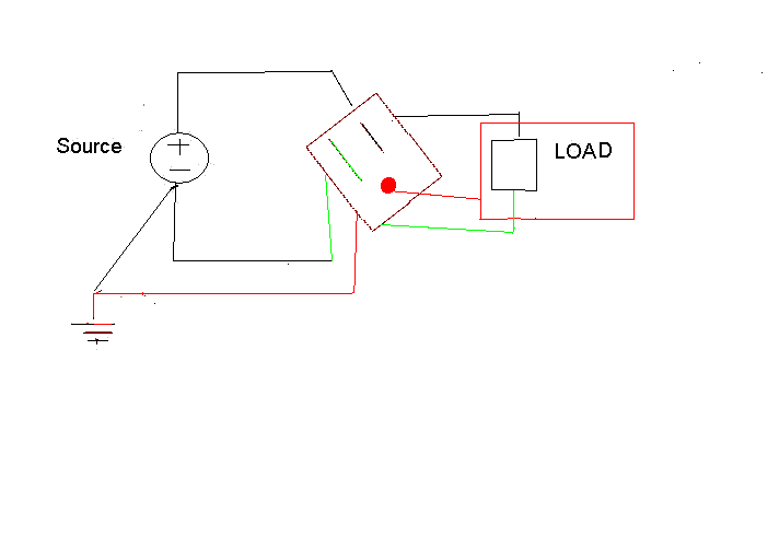

I SEEEEEEE I THINK lol...
I hope this is right to say... CHECK PIC :)??
I HOPE THAT IS RIGHT: IF IT IS
IS THE BLACK THE LIVE WIRE
GREEN THE NEUTRAL WIRE
THE RED THE GROUND WIRE:s
Yes, that's it. You also got the narrow & wide slots correct!
AWESOME!
thanks to everyone who helped me, i was very confused about that for a while now.
THANKS A LOT!

In your outlet box,
Black is the hot wire (will knock you down if you touch it while you are grounded)
White is the current-carrying neutral wire (is grounded at the panel and will not knock you down if touched separately)
Green is the ground wire (is also grounded and will not knock you down if touched)
