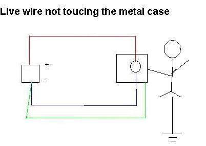

Is it possible for someone to explain why this individual gets electrocuted...(check image)..
I know MGB explained but I am still confused for some reason. I do not understand how this is a complete circuit. Can someone trace the current for me? :S
(Image: Yes that is a short no ground connection).

In the absence of anything else (e.g. the power supply negative terminal being at higher potential than the ground the guy's standing on), the individual does not get electrocuted.

if the negative terminal is at a higher potential i still do not really understand how current would flow through the individual...
Is it NOT necessary that in AC Circuits the "End" which is the "EARTH" be connected to the negative terminal for the circuit to work..?
  • #74
But wasn't the premise of the question that the circuit was not, in fact, connected to earth? If the negative terminal of the circuit is at a different potential than ground, then this could be represented as another power supply with the hot end connected to the negative end of the first supply, and with its negative end connected to ground. Since this was not in the question, then no, the individual will not be electrocuted.
You *could* have AC circuits not connected to Earth ground. If you had a petrol generator, for instance, and you plugged a power drill into it, that power drill wouldn't be connected to Earth ground, and would still work (it'd still have the case grounding present, though this would be connected to the local ground--probably the generator casing). Assuming you sat the generator on a big, thick, sheet of something non-conductive, and you stood off of this sheet, you would have no current flow through you (and to ground) if you jammed your screwdriver into any ONE of the generator's outlet prongs. Now, if you were to jam a screw driver into one prong with one hand, and to jam another screwdriver into the other prong with your other hand, you may (literally) be playing with fire.
In most circuit diagrams, you usually see some kind of ground (or even, several types of these mixed together). These do not mean the same thing, as mentioned in another post in this thread regarding the various faces of "ground", and very often do not mean Earth ground. Except when they do (but this is usually stated somewhere).

I made a diagram, can someone complete circuit B and does current flow through the guy?First Diagram: https://www.physicsforums.com/attachment.php?attachmentid=15144&d=1219436573
Assuming the 1000V is relative to ground (and the bottom generator of circuit B is what provides the 1000V to the top generator), the poor individual will be in parallel with the bottom generator (and implicitly, his feet are connected to the bottom terminal of the bottom generator via ground). How much current will flow through him? Depends on how much resistance he has. Hopefully, he's got on really thick rubber boots...
EDIT: I believe this is the quote you refer to:
mgb_phys said:
That is said to be a 'floating' circuit and for a battery powered circuit it wouldn't matter.
But if it is floating then the + and - can be any voltage above 0 there is nothing to make the - terminal the same voltage as the Earth.
So suppose the + was at 1100V and the - was at 1000V, the circuit would work fine. But if you touched the case, even without any fault, the case would be at 1000V above ground and your feet would be connected to 0V so you would provide a path for the current to flow through!
The reason the Earth is used as a reference is that it is also the thing you are msot likely to be touching ! And you can be sure that the Earth in your house is at the same voltage as the Earth at the power station.
I hope this makes sense, but sometimes, when things have been fuzzy, I've accepted them and moved on. Only later (with more experience, or something that forced me to make use of them), did they finally make sense.

Ok. Thank you, I guess that makes sense that the individual would become parallel with the "potential difference" and so current would flow through alright. THANKSSSSSSSSSSSSS this is a great thread for me. :)
