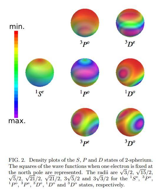

TeethWhitener said:
https://arxiv.org/abs/1004.3641If anyone’s interested in the state of the problem.
So as one would expect, the groundstate does correspond to the classical antipodal configuration.
  • Six colour-mapped density plots on spheres, labelled 1Se, 3Po, 3De, 1Po, 1Do, 3Pe and 3Do, with a colour bar from min. (red) to max. (purple) beside them, showing the squared wave functions for 2-spherium.
