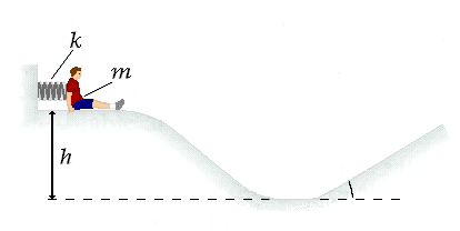

A spring with constant 72500.0 N/m is compressed 54.6 cm and used to launch a 109.0 kg physics student. The student starts decending down a 13.4 m high track that is frictionless until the student starts up the incline again. The student's coefficient of kinetic friction on the 28.5° incline is 0.129. What is the student's speed just after losing contact with the spring?
e=0.5mv2
eg=mgh
spring = 0.5kx2
alright for this question i equated the mgh+0.5mv2 = 0.5kx2
and solved for v ... is this the wrong thinking for this question pls. help

Is this a V shaped track? It goes down and then up again?
As to your approach, can you think of why they gave you the coefficient of friction?
its more of a u-shaped curve...and the coefficient of friction is given for the incline which isn't frictionless..but theyre asking for speed right as it leaves the spring so i didnt think the coefficient mattered

The down half is frictionless right? So there is no need to account for it there. But there is on the other side.

Edit: Apparently they only want the speed off the spring after compression .56m. In what I suppose must just be the first part of a several part question. In which case for that won't that just be 1/2*mv2 = 1/2*k*x2 + m*g*sin28.5*.56m ?
i have a quick question.. i did this question a different way using only 0.5*k*x^2=0.5m*v^2... i didnt use m*g*sin28.5*.56m but i still got the right answer and i was wondering how was that possible??i got 14.1 from my way and 14.3 from the way you did not a big difference but still puzzling to me
Now that I see the image, now that it's approved, there was the assumption on my part at the time that the spring was pointing down hill. The additional term would take care of the additional assist from gravity over the launching of the boy. Since he was launched horizontally, then that term is not needed.
