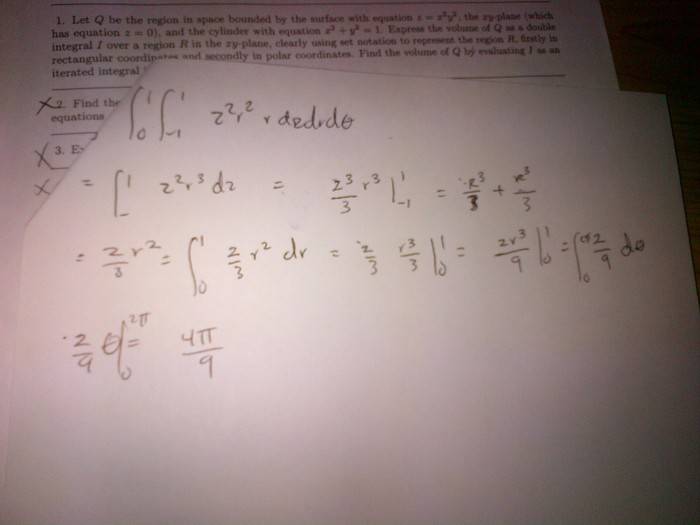

my answer ended up being 4pi/9!
Did you remember to include the r in r dz dr dtheta?
yep basically i did this
∫2pi-0 ∫1-0 ∫ 1-(-1) z^2 r^3 dz dr dtheta
i multiplied z^2r^2 by r so i got r^3
(first digit means upper limit for integral)
correction answer is pi/6 right?
Yes, pi/6.
