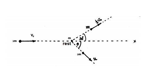

Mass of 2m slides on a horizontal plane with the velocity of v0 across the x-axis. And hits the mass m which is in rest. after the collision mass m moves with the velocity of v0/2 in the direction which creates an angle of 30 degrees of the original movmen of 2m.
a) What is the velocity of mass 2m after the collision?
b) What is the direction of mass 2m after the collision?
c) Is the collision described is perfectly ellastic collision?

I have broken down the velocity to x,yPinitialx=Pfinalx
m1*V1ix+m2*V2ix=m1*V1fx+m2*v2fx
2m*v0+m*0 = 2m*Vfcosθ+m*v0/2*cos30Pintialy=Pfinaly
m1*V1iy+m2*V2iy=m1*V1fy+m2*v2fy
0 = -2m*Vfsinθ+m*V0/2sin30
I don't know what to do from here. i can't simplfy the equations,
could you help me with that?
Thank you,

Your figure has Vf as u. That's a bit handier.
What are the values of sin30° and cos30° ?
Solve 0 = -2m*u*sinθ+m*(u/2)sin30 for u. (EDIT: This is corrected below.)
Solve 0 = -2m*u*sinθ+m*(V0/2)sin30 for u.
Plug that result into the other equation:
2m*u+m*0 = 2m*u*cosθ+m*(u/2)*cos30
2m*u+m*0 = 2m*u*cosθ+m*(V0/2)*cos30
2m*V0+m*0 = 2m*u*cosθ+m*(V0/2)*cos30
Solve for cotθ (Lots of stuff cancels.)

I'll get you started.
To solve 0 = -2m⋅u⋅sinθ+m⋅(V0/2)sin30 for u, subtract the first term from both sides. (Add its opposite.)
2m⋅u⋅sinθ = m⋅(V0/2)sin30
Then divide both sides by 2m⋅sinθ. Right? What do you get?
I got
u=05V0*sin30/2sinθ
Xenon said:
I got
u=05V0*sin30/2sinθ
Using the "reply" feature will help you make more readable posts. Then you can cut & paste more accurately. Also, to make a subscript, use the X2 icon on the green strip above the message box you use to form your message to post.
You should use parentheses around that denominator. The leading 05 is missing a decimal point. You might as well divide 0.5 by 2 .
u = (0.5)V0⋅sin30/(2⋅sinθ)
u = (0.25)V0⋅sin30/(sinθ)​
By the way, do you know the value of sin(30°) ?
So
u = (0.125)V0/(sinθ)
How is that looking?
