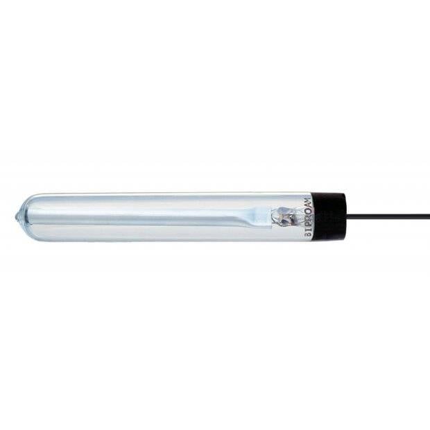

I need to know what is this type of lamp and a datasheet.
Hi there!
I have few years still without any solution.
I could find just only one exemplary of this bulb or lamp there I share pictures, this is exactly what I need to know what it is, brand or datasheet.
The base is E27.
AND the most important, In this VIDEO you can see the lamp working: (I don't know is this usage is the correct usage, the lamp is powered with HV with only a single cable, it runs like a Plasma ball lamp) - Aparenlty these lamps are used to generate ozone.
Hope you can help me! I have YEARS with this issue... I never could resolve it...
Kindly Regards ;D
By HV, do you mean High Voltage? How is that to be reconciled with the E27 socket?I'm a bit puzzled. If you don't know what it is, how do you know you need it?
This is the lamp the same with not the E27 base. I think the E27 base can be useful to find something more "standart". I think this type of lamp is not designed to work with HV and making ozone, and this is the information I need, what is this type of lamp NORMALLY and what it is used for?

The first image and the image in Post#3 appear to be the same lamp, so the search path below was followed.
The post#3 image has "BIPROAM" on the lamp, suggesting this search:
https://www.google.com/search?hl=en&source=hp&biw=&bih=&q=biproam
The fourth image of that Google search matches post#3 and leads to:
https://www.todoelectronica.com/lampara-ozono-100mm-resina-cable-silicona-p-89936.html
Google can not translate that page directly, but you can copy-paste the page text to Google translate to get something readable.
the lamp is:
a) an ultraviolet lamp
b) the UV generates Ozone from the Oxygen in the air
c) intended use is for disinfecting
I spotted 'Neon' and '28nM' somewhere on the site.
Cheers,
Tom

It matches the image in post #3 EXACTLY. I smell a rat: if @Axxel has the same picture as on a web page how do they not know what the bulb is from the web page?
At first, I thought it might be a uv aquarium sterilizer.
A low-pressure mercury vapour discharge inside the tube would generate UV, which in turn, generates ozone in the air outside the envelope.
The tube seems to have only one high voltage connection to the internal element. An electric field would need to pass through the capacitance of the envelope to the external "ground". I would expect the tube to be driven by high frequency AC, from a high voltage generator. Discharge current would be regulated by the capacitance of the glass envelope, the voltage and the frequency of excitation.
