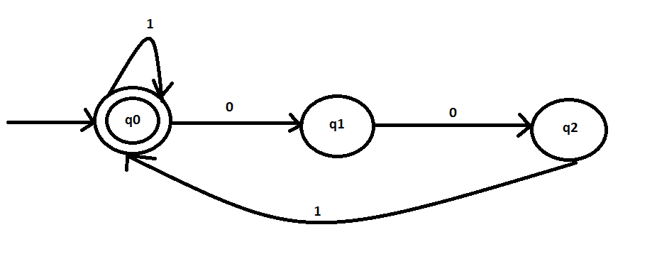

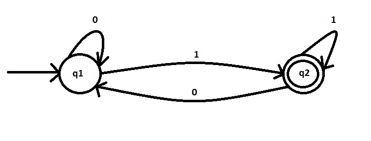

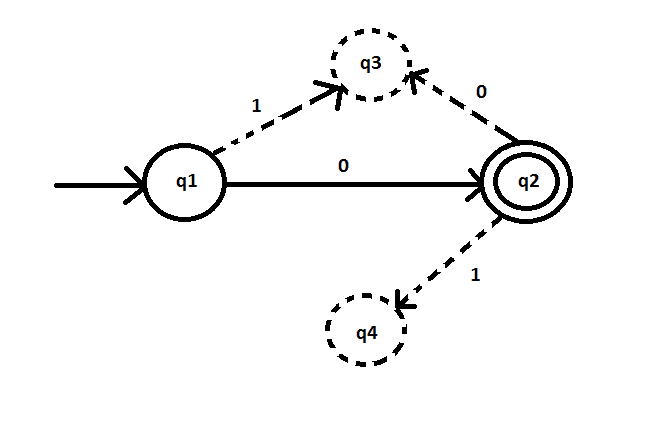

The following DFA is given:
I want to find the language that it recognizes. The alphabet is $\Sigma=\{0,1\}$.
Isn't the language this one: $(0^{\ast} 1^{+} 0^{\ast} )^{+}$?

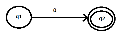

  • $\{0\}$, with two states

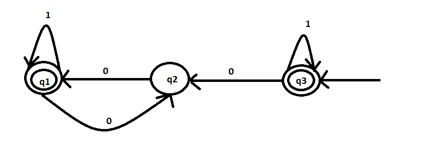

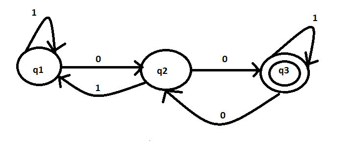

  • $1^{\ast} (001^+)^{\ast}$, with 3 states

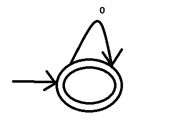

  • $\{ \epsilon \}$ , with 1 state
  • $0^{\ast}$ with 1 state
But can it be that $1$ goes nowhere? :eek:

Hey evinda! (Wave)
Does the DFA allow a $0$ at the end? (Wondering)
It depends on the definition of a DFA that you have. Does it allow that? (Wondering)
As far as I'm concerned, it should be fine if $1$ doesn't go anywhere - it keeps the DFA simple and straight forward.

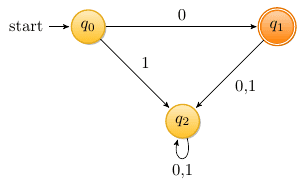

But if we want $1$ to go somewhere as well, we can introduce a new state that we call sink and define a transition for $1$ to it. Since it's not a final state, the machine can be "stuck" there and not accept the word.
But then the word $1$ isn't accepted... What could we change?
You didn't identify the start state yet. :eek:
How about making $q_3$ the start state?
Btw, doesn't your machine accept an arbitrary number of consecutive $0$'s? Should it? (Wondering)

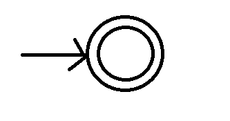

Can it be that 0 and 1 go nowhere?
Again $1$ goes nowhere... Is that possible?
Same thing, if necessary we can introduce a sink state.
No, it doesn't... (Shake) So should the language be of the following form?
$(0^{\ast} 1^+ 0^{+}1)^{\ast}$
But now we have again consecutive 0s ... What could we do to change that? (Thinking)
https://www.physicsforums.com/attachments/5685
How about the word $1$? Does the DFA accept it? And your expression? (Wondering)Let's go through this state by state.
In state q1 we can accept $0^*$ followed by $1$ to q2 followed by $1\ast$ after which we can stop.
That is: $0^* 1 1^* = 0^* 1^+$.
After that, we can go back to q1 with $0$, followed by $0^*$, followed again by $1 1^*$ after which we can stop.
So: $0^* 1 1^* 0 0^* 1 1^* = 0^* 1^+ 0^+ 1^+$.
And we can keep going to get: $0^* 1^+ 0^+ 1^+ 0^+ 1^+ 0^+ 1^+ ...$.
So we can have:
0^* 1^+ \\
0^* 1^+ 0^+ 1^+ \\
Hmm, how can we abbreviate that? (Wondering)

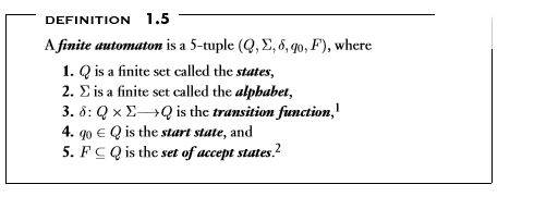

The fact that $\delta$ is a function of $Q\times \Sigma$ implies that every state should have outgoing arrows for each input symbol.
However, with the number of supposed states that is given for each problem, there is no room for a sink. (Nerd)
Btw, it specifies that the start state should be $q_0$, but that's not the case in your DFA's. :eek:
So you mean that the DFA could be drawn as follows?
I was thinking more of:
However, the problem statement says you should have 2 states, so I don't think you're supposed to include a sink.

Let's start with introducing new states where needed.
We should get the following DFA:
Agreed? (Wondering)
However, we should have 3 states instead of 4.
Fortunately states $q_0$ and $q_3$ look the same.
Could we leave out $q_3$ and redirect its arrows to $q_0$? (Wondering)

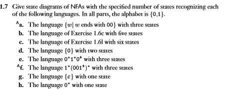

1. It would be better to devote its own thread to every question. Discussing five automata in one thread is confusing.
2. I believe you are using the Sipser's book "Introduction To The Theory Of Computation". There the transition function of a DFA returns a state and is total, i.e., every state must have an outgoing arrow for every symbol. This is in contrast to NFAs, where the transition function returns a set (possibly empty) of states. I believe it is not possible to construct a DFA with one state accepting $\{\varepsilon\}$ or $0^*$,but it is possible to construct such NFAs.
3. It would be helpful of you specify exercise numbers if exercises are taken from the Sipser's book.
So we can have:
0^* 1^+ \\
0^* 1^+ 0^+ 1^+ \\
So the language is this one: $0^{\ast} 1^+ (0^+ 1^+)^{\ast}$, right?

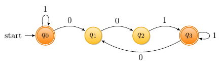

Agreed? (Wondering)
Yes... (Nod) Ah, I see... Then the DFA will be the following, right?
I found these exercises from some notes of computability theory, but the most of them are from the Sipser's book. Next time I will specify the exercise numbers.
I've always been a bit confused about these definitions.
The FA's we have here are all deterministic, even though not all input symbols have a state transition.
Still, we can consider every missing symbol to have an implicit transition to an extra sink state.
That's very different from a non-deterministic FA that would typically have multiple state transitions for the same symbol.
So what's the big deal that a DFA is supposed to have a transition for every symbol?
Yes. We can even further abbreviate it to $(0^*1^+)^+$. (Nod)
Does this often happen that we draw a dfa with one more state than the desired number and that the final state is equal to the initial one?
Yes. We will have to do whatever is required for the problem statement.
Usually there is no real need to reduce the number of states though - it's just an optimization that happens to look more pleasing to the eye and is less work to draw. (Wink)

Do we have the DFA that accepts only the $\emptyset$ if $q_0$ is a non-accepting state and the DFA that accepts $\{0,1\}^*$ otherwise?
Yes.
