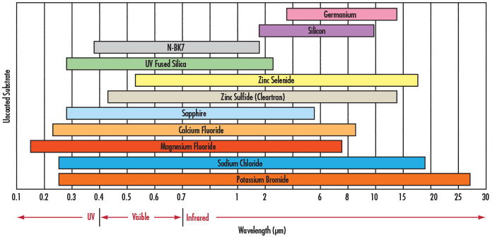

You're looking for transmission of mid-wavelength and long-wavelength infrared, 3 to 15 micrometers.
If you can keep things dry, a thin sheet of salt (Sodium Chloride) or Potassium Bromide would work.
But Zinc Selenide would be more practical.
$60 on ebay. http://www.ebay.com/itm/like/262478291062?lpid=82&chn=ps&ul_noapp=true
