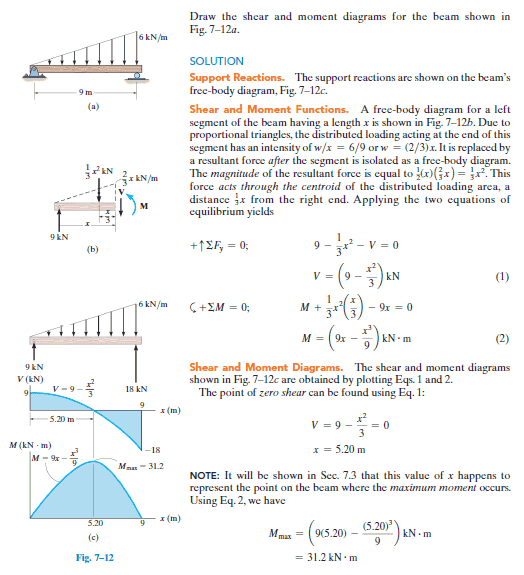

This is the original problem of what I asked:
Shear and moment diagrams for a 9 m beam with a triangular distributed load of 6 kN/m, showing V in kN starting at 9 kN and crossing zero at 5.20 m, and M in kN·m peaking at 31.2 kN·m.
How do I draw the V shear and M moment graph like above?
The image and question (post #16) seem to give a sense of mechanical engineering or Physics(mechanics). One would learn to draw pictorial figures AND make graphs throughout Mathematics courses and not only starting with Algebra 1. You first asked "What Math Class Teaches us how to Draw a Graph"? ALL OF THEM!
I will go out on a limb and try to answer the original question, but I could easily make mistakes.
To graph y = 9x - x^3/9, first set y = 0 and get x = 0, 9, -9. If one also notes that the leading term is a constant multiple of -x^3, one knows the graph comes down from + infinity on the extreme left and goes down to - infinity at the extreme right. Hence just graphing these 3 points, (-9,0), (0,0), and (9,0), one knows the graph comes down from the left, crosses the x-axis at (-9,0), then at some point between x= - 9, and x= 0 , the graph turns up again, crossing the x-axis at (0,0), continues upward, then turns down again at some point between x=0 and x = 9, and goes down again, crossing the x-axis at (9,0), then continues on down to minus infinity. Calculus is not really needed for this rough graph, which looks a bit like a fishhook on the left, and an upside down fishhook on the right, with their points meeting at (0,0).
To find the 2 turning points, use calculus to take a derivative, getting y' = 9 - x^2/3, and set it equal to zero, getting x^2 = 27, or x = ± sqrt(27). Plotting these two points gives the turning points as (-sqrt(27), -6sqrt(27)), and (sqrt(27), 6 sqrt(27)).
To clarify that the curvature does indeed change from concave up to concave down at (0,0), compute the second derivative y'' = -2x/3, set it equal to zero, getting x=0.
To compute the slope of the graph at this "inflection" point, compute y'(0) = 9, getting the slope of the tangent line at (0,0).
That is about what a calculus student of mine would learn.
