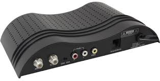

i'd peruse local yardsales and thrift stores for a digital converter box and hook it to an antenna. Walmart still sells them, as do a couple other places. BUt they are common in junkshops.
your folks probably have one left over- ask your friends and neighbors too, you'll find one.
then go to site antennaweb dot org to find out what channels are available in your neighborhood and what are their frequencies. The little GE converter unit above displays the frequencies for you...
then google "folded dipole antenna".
i built one out of #12 house wire and 3/4 inch PVC pipe. Cost less than $10. That style antenna matches 300 ohm twin lead or, if you solder it to an antenna transformer you can use coaxial cable. Works good to put the transformer in a tee with pipe out each side to support the wire loop, and another pipe out the bottom for a mount. Cable or twin lead comes down that pipe of course.. Attach it with conduit clamps to most anything, my building had a roof mounted airconditioner and i just put the conduit clamp under one of its side panel screws..
My folded dipole antenna is 27 inches long which worked very well for the frequencies in my town.

i soldered in an antenna matching transformer (50 cents at Goodwill) and used TV coax for feeder.
