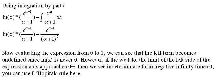

Hello,
I need to find the values of alpha for which the following integral converges:
[tex]\int x^\alpha*ln(x)[/tex] the integral is from 0 to 1.
I don't really know which test should I use or how to calculate the limit of the integral as x->o+
Please see attachment for some insight.
I still can't see how to find the alphas given that statement after you integrated
This might not be the correct approach to the problem, I was just trying to give you some insight that perhaps would be helpful. Hopefully someone will clarify this further.
I'm sorry for the bump. Can anyone please help?
It's really all in proceeding from the hint given in the attachment.
You end up with
[tex]\left(\frac{1}{\alpha+1}x^{\alpha+1}\ln(x)\right)\bigg|_0^1 - \left(\frac{1}{(\alpha+1)^2}x^{\alpha+1}\right)\bigg|_0^1[/tex]
This will exist if (and only if) the two limits
[tex]\lim_{x\to 0^+}\frac{1}{\alpha+1}x^{\alpha+1}\ln(x),\quad <br /> \lim_{x\to 0^+}\frac{1}{(\alpha+1)^2}x^{\alpha+1}[/tex]
both exist. Use L'Hospital's rule for the first (write it with [tex]x^{-\alpha-1}[/tex]) on bottom, and the second is immediate. You should get the same answer for both
limits working out.

I understand this steps and everything but I still can't see how to get a specific alphas for which the integral converges. How can I find them?
