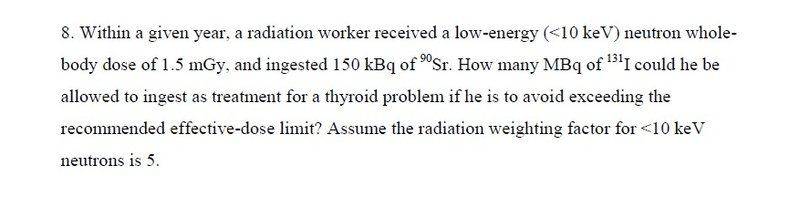

Question attached.
I want to check what values of WT I should use.
Effective dose = WT*WR*WT,R
For the neutron whole-body dose I have WT = 1.
For the ingested 90Sr and 131I, I also have WT = 1. Are these correct or does "ingested" mean I should take a value of WT = 0.12 (stomach), or should I use WT = 0.04 (thyroid)?
Thank you for any help
Hi,
First you must calculate the effective dose du to neutrons with Wr, second calculate the effective dose du to ingestion of Sr (with dose intake conversion factor)
Hi, yes I've done that, I need to know what values of WT to use. But actually you said I don't need to use WT as I used a coefficient. I will send you my answer by pm.
