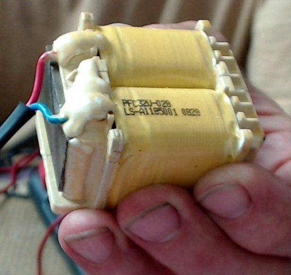

What's the purpose of this dual coil?
It has a blue and red cable.
It stood alone, mounted (isolated) on the chassis of a PC PSU.
It's in good condition, so I'm keeping it, but what can be achieved with it?

if there is ONLY 2 wires, then it is likely a choke
please confirm that there is only 2 terminals

Yes... specifically blue & red - reading 2.3 Ω
This is what confused me.
Only two connectors (each end of the windings).
Almost no resistance.
Yet cabled blue and red (traditionally +ve -ve).
I looked up choke, but so far, enlightenment has not arrived.
...Ah... but electronic ballast, provides I believe a better explanation (if this is what it is).
Am I correct in believing that this would be placed in the +ve feed to a component?
(but it has blue and red cables... so I'm not sure.)

I agree with Dave. You can see the iron core and coils wound around the limbs. Perhaps they are in connected in series aiding fashion, so their mutual inductance increases the effective inductance.
But I can't tell the exact function of that choke. I'll have to do some reading..

I wonder if PFC written on it means anything ?

Yes, Power Factor Correction.
I just tried it in series with a motor.
The PSU puts out 19v DC no load.
With the motor running, it drops to 7v.
It can be dropped down to 4v and still run.
With the coil in series - still 19v no load.
With the motor ON the voltage drops to 4v but no sign of life from the motor.
Therefore it appears to be greatly limiting the current flow.

Marcophys - It won't be to limit current. Google Power Factor Correction.
This is mainly an issue for business users as the electricity meters in commercial and business premises effectively charge more if the equipment used has poor power factor. I don't think the meter in most domestic buildings (eg houses) cares about power factor.

In an AC circuit the voltage and current going into a device like a power supply aren't always in phase. This effects the efficiency with which power is used. It is a particular problem where the device is reactive (eg it contains capacitors or inductors). To fix the problem additional capacitors or Inductors can be added to try and get the voltage and current back in phase. You have probably got one of these inductors.
