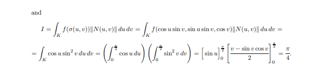

jacobian is r^2 sinv
Greetings!
here is the solution which I undertand very well:
my question is:
if we go the spherical coordinates shouldn't we use the jacobian r^2*sinv?
thank you!
It's sort of already baked in. The surface element comes from a little parallelogram with sides ##d\boldsymbol{l}_u = \frac{\partial \boldsymbol{\sigma}}{\partial u} du## and ##d\boldsymbol{l}_v = \frac{\partial \boldsymbol{\sigma}}{\partial v} dv## and therefore area
\begin{align*}
dS = |d\boldsymbol{l}_u \times d\boldsymbol{l}_v| = \left| \frac{\partial \boldsymbol{\sigma}}{\partial u} \times \frac{\partial \boldsymbol{\sigma}}{\partial v} \right| du dv
\end{align*}The part ##\frac{\partial \boldsymbol{\sigma}}{\partial u} \times \frac{\partial \boldsymbol{\sigma}}{\partial v}## is what your solutions denoted by the vector ##\mathbf{N}##.
