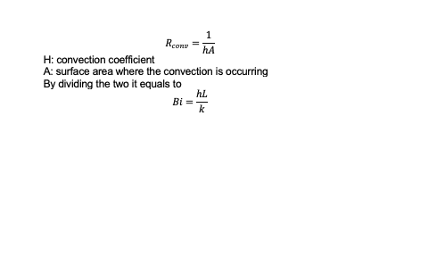

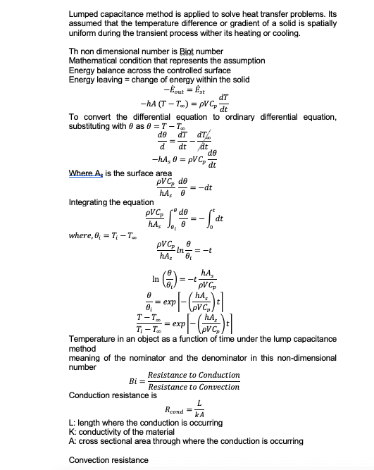

What is the main assumption to apply the lumped capacitance method? What particular non dimensional number and what mathematical condition represent this assumption? What is the meaning of the nominator and the denominator in this non-dimensional number?
Energy released
Biot number
I attached below my attempt to solve the question.

In a system like this, the asymptotic internal resistance to heat at long times is proportional to L/k and the external resistance is proportional to 1/h. The lumped parameter approach is valid if the external resistance dominates, or when $$\frac{1}{h}>>\frac{L}{k}$$or when $$\frac{k}{Lh}>>1$$ or, equivalently, when Bi << 1.
