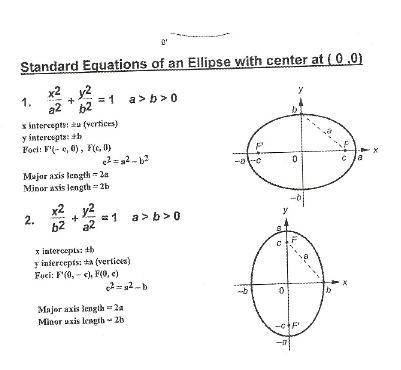

when we use standerd Equation of an ellipse
here 2 formula 1 and 2 when we use 1 and when we use 2
hlep me

Errr... what's the difference, except that a is called b and b is called a in (2)?
when we say a is called b and b is called a in the queation
i mean in queation how we nowthe solve will be by formula 1 or 2

The two formulas shown in the page you scanned are needlessly complicated. Only one equation is needed for an ellipse.
[tex]\frac{x^2}{a^2} + \frac{y^2}{b^2} = 1[/tex]
If a > b, the major axis is along the x axis.
If a < b, the major axis is along the y axis.
Ex. 1
[tex]\frac{x^2}{25} + \frac{y^2}{16} = 1[/tex]
x-intercepts (vertices) at (5, 0) and (-5, 0).
y-intercepts at (0, 4), and (0, -4).
Foci at (3, 0) and (-3, 0).
Ex. 2
[tex]\frac{x^2}{16} + \frac{y^2}{25} = 1[/tex]
x-intercepts at (4, 0) and (-4, 0).
y-intercepts (vertices) at (0, 5), and (0, -5).
Foci at (0, 3) and (0, -3).
The b2 and a2 (depending on position) tell you the major and minor axis and which way to ellipse will be (like vertical or horizontal)
keep in mind: a cannot equal b because then it will be a circle not an ellipse.
