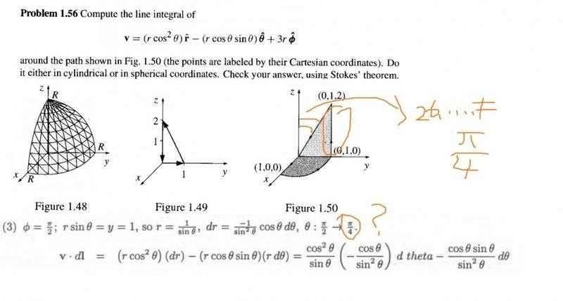

where is pi/4 coming from in the line integral(section 3)?
because i think it should be 1/2=tan(theta) which theta is 26.5651...
it is impossible that the angle is pi/4? where is pi/4 coming from inside the circle?

  • Handwritten worked solution to Problem 1.56 with Figure 1.50 path labels (0,1,2), (0,1,0) and (1,0,0); orange annotations mark an arrow to 26...° and pi/4, and a line from theta = pi/2 to pi/4 in the line integral setup.

in section 3
which is the part of the straight line toward z axis
i think the angle should not be pi/4?
this is spherical coordinate
Ok, I assume that you have the standard definition of spherical coordinates with the ##z## axis as the polar axis, as
$$\begin{pmatrix}x\\y\\z \end{pmatrix}=r \begin{pmatrix} \cos \varphi \sin \vartheta \\ \sin \varphi \sin \vartheta \\ \cos \vartheta \end{pmatrix}.$$
Then the straight line parallel to the ##z## axis is at ##\varphi=\pi/2=\text{const}##. Otherwise it's awful to describe in spherical coordinates.
For the quarter-circle it's easy to use spherical coordinates, it's given by ##\vartheta=\pi/2##, ##\varphi \in [0,\pi/2]##, ##r=1##.
For the straight lines I'd use Cartesian coordinates, where they are expressed straight forwardly. It's easy to rewrite the field in terms of Cartesian coordinates. Just note that
$$\hat{r}=\begin{pmatrix} \cos \varphi \sin \vartheta \\ \sin \varphi \sin \vartheta \\ \cos \vartheta \end{pmatrix}, \quad \hat{\vartheta}=\begin{pmatrix} \cos \varphi \cos \vartheta \\ \sin \varphi \cos \vartheta \\ - \sin \vartheta \end{pmatrix}, \quad \hat{\varphi}=\begin{pmatrix} -\sin \varphi \\ \cos \varphi \\0 \end{pmatrix}.$$
garylau said:
Where is pi/4 coming from in the line integral(section 3)?
You're right. It's a mistake.
