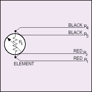

Hi all,
We are planning to use RTD (Resistance temperature detectors) for our system which basically are temperature sensors that contain a resistor that changes resistance value as its temperature changes. The RTD can come in two nominal values: either 100 ohm or 1k ohm. Knowing that the RTD work by current excitation and the sensor will fed from the data acquisition by 1 mA for the 100 ohm RTD, and by 0.1 mA for the 1k ohm RTD.
My question is regarding which one might be less prone to receive noise from the environment (that may contain a motor, variable frequency drive...etc)?

In fact to elimnate any error related to the lead resistance, we were planning to use the 4-wire RTD arrangement which I think correlates exactly with what you said about using pair of twisted cables. Using this 4-wire configuration (shown below), as you confirmed will increase the accuracy and reliability of the resistance being measured, and the resistance error due to lead wire resistance shall be zero.
Probably now, my concern: Which one might be less prone to receive noise from through EMI, a 4-wire 100 ohm RTD OR a 4-wire 1K ohm RTD ? According to Tom's explanation above, the 100 ohm RTD shall be less in receiving external noise. Is there any estimate of how much would the 1K ohm pick up noise more than the 100 ohm, and how can we judge if this difference can be negligible?
The solo advanatge I can see so far of the 4-wire 1K RTD over the 4-wire 100 ohm RTD is just better resolution (it can detect smaller change in temperature)?

You are certainly on the right track for accuracy by using 4-wire RTDs.
Other things to consider for high accuracy are:
  • Operating Temperature - High temps need Kapton or Teflon insulation.
  • Damp or Wet environments (especially over a few tens of feet) - Generally need Teflon insulation for 1% or better accuracy (PVC absorbs too much moisture).
  • Use twisted, shielded cable for maximum noise immunity. Ground the shield at only one end, usually at the electronics end.
  • Use a continuous length of wire if at all possible. If you MUST splice, use screw terminal blocks and tighten securely.
  • Put all wire runs in metallic conduit, preferably steel if in a high magnetic field environment, i.e. near high HP motors, transformers, or power lines supplying them.
  • Use RTDs that are guaranteed interchangeable to the desired accuracy - for when you have to replace one.
There may be other gotcha's depending on your specific application, which you haven't yet shared.

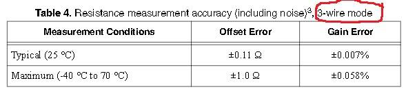

The RTD that we plan to use belongs to Class A, which has accuracy defined as: Class A = ±(0.15 + 0.002* t) [-30 to 300°C] (Where t is temperature). The data acquisition module is either NI 9216 for 100 RTD OR NI 9226 for 1K RTD. Both NI devices have similar temperature accuracy, but the offset error for 1K RTD is of factor of 10 compared to 100 RTD (as shown Page 5).
We won't be switching or multiplexing, these NI modules provide the excitation current (1 mA or 0.1 mA) per channel (or per RTD). But I agree with you that this is another advantage for the 1K RTD is that it has less self heating power. Here the self heating index (SHI) comes into play, which is the ratio of resistance changes (in ohms) to unit electric power generated in the RTD sensing element (in mW) as the result of application of electric current (EX: SHI = 25 mW/ °C; thus if you have self heating power=25 mW, this will give you 1 °C error). The SHI should be provided by the RTD manufacturer, but sometimes they don't do so. If we assume same SHI for both RTDs, then I think that means that 1K RTD might have better accuracy over 100 RTD in that regard.

AAO said:
but the offset error for 1K RTD is of factor of 10 compared to 100 RTD (as shown Page 6).
Observe:
1. They give that error in OHMS not degrees and your Pt1000 has tenX the ohms per degree,
...so i think they're equivalent.
2. Offset Error shown is for 3 wire measurement and you're using 4 wire ?

1- Yes, you are correct! they are equivalent.
2- I was mistaken in the page number, it should be page 5 (for 4-wire). I have corrected that on my previous reply too. Thanks for the catch!
