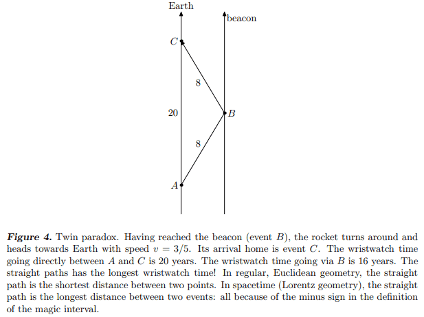

darth boozer said:
It looks like you have transposed hypotenuse and opposite side! The hypotenuse cannot be shorter than the other two sides.
It can when your metric is ##ds^2=-c^2 dt^2 + dx^2 + dy^2 + dz^2##
  • #32
What is the justification for classifying the 4-interval as a measure of "distance" or "path length", as opposed to being a function with some other physical significance? It makes no sense to me at all.
  • #33
Because mathematically the path length is ##ds^2=dx^2+dy^2+dz^2##. So when ##dt=0## the spacetime interval reduces directly to the standard distance formula. Then the spacetime interval formula is a straightforward generalization of the distance formula.
The justification for it being a generalization distance isn’t terribly interesting. The interesting thing is that it is experimentally validated.

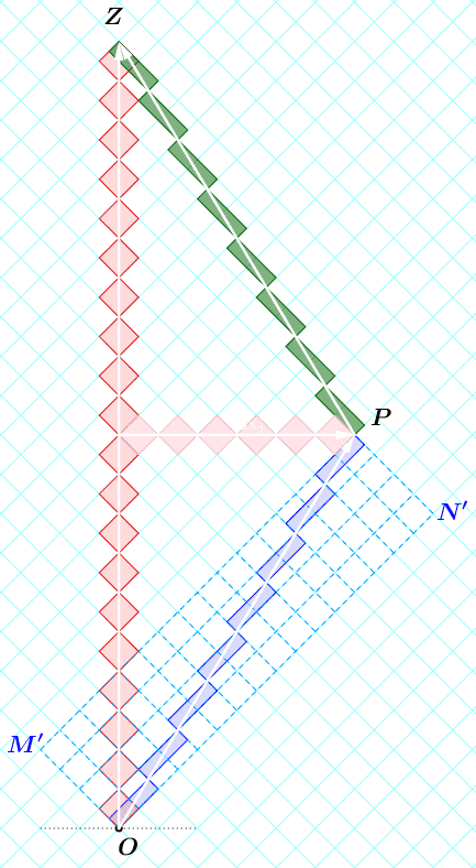

There is an Euclidean version of space-time diagrams, where the coordinate-time is the path length (hypotenuse ), while the proper-time is the axis. It is more intuitive for a single object, because you see the time-dilation and length contraction directly as projections onto the axes:
http://www.adamtoons.de/physics/relativity.html
But it's less useful for multiple objects, because you don't see their meetings as crossings of the world lines. Here a comparison of the two diagrams:
http://www.adamtoons.de/physics/twins.html
Note that modern browsers block flash-animations by default. You have to explicitly allow it.

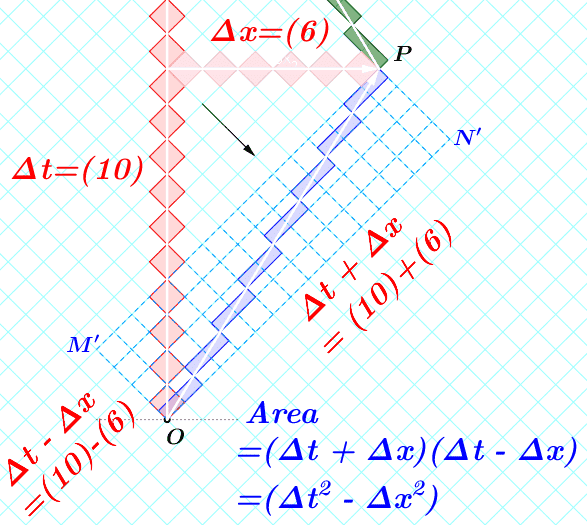

Mathematicians and some physicists will shout at you if you call an interval a length. But it occupies basically the same position in the maths - it's the simplest thing you can build from coordinate differentials that is invariant under coordinate transform. In Cartesian coordinates in Euclidean space, the length associated with a coordinate difference ##d\vec x## is ##dl##, which is given by ##(dl^2)=d\vec x^T\mathbf{I}d\vec x## where ##\mathbf{I}## is the identity matrix. In Minkowski spacetime, ##(ds)^2=d\vec x^T\mathbf{\eta}d\vec x##, where ##\mathbf{\eta}=\mathrm{diag}(-1,1,1,1)## is the metric of Minkowski spacetime. Since the metric is what defines the properties of spacetime and the only difference between these two expressions is the choice of metric (##\mathbf{I}## for Euclidean space and ##\mathbf{\eta}## for Minkowski) they are clearly analogous. You probably shouldn't, strictly, call the interval a length (its square can be negative, and this has Implications) but it's in the realm of "typical physicist sloppy attitude to fine mathematical distinction".
You might ask why I can't write ##d\vec x^Td\vec x##. That's a good question but the answer would involve explaining more about tensors than I'm willing to explain in a post. Suffice to say that it doesn't make sense, and it only works in the Euclidean+Cartesian case because the metric tensor happens to be the identity matrix which let's you get away with stuff.

The justification goes to the heart of the OP's question: What makes moving clocks tick more slowly? Why does the clock from the rocket in the twin paradox show a different elapsed time compared to clocks on Earth when it returns to Earth? The only explanation I've seen on this website is that the spaceship takes a "shorter route through spacetime", and the only way that answer can be a scientific explanation is if it has a scientific justification. But when I ask what that justification is, you tell me it's "not interesting".
There's no evidence that the 4-interval measures anything that can reasonably be called "distance" or "length", so use of those terms in "explaining" relativistic phenomena is a misleading abuse of classical concepts. No matter what reference frame you use to analyze the twin paradox, less time elapses on the spaceship than on Earth, and the principle of relativity is inconsistent with any deterministic mechanism to make that happen. What is consistent with determinism is the interpretation proposed by HA Lorentz: that there's some kind of trade-off between center-of-mass motion through the vacuum and other behaviors of matter, including the internal motions of ticking clocks.
  • #38
Apart from the maths I did in my last post. And that it actually is literally distance for a spacelike path. And that it's literally elapsed time for any timelike path.
Um... you can use the principle of relativity to derive the maths used in special relativity. So the results you say are inconsistent with the principle of relativity actually follow from it.
Please don't confuse "you don't like the geometrical interpretation of relativity" with "it is wrong". Lorentz ether theory gives the same results as the geometrical interpretation, but requires the addition of an undetectable "preferred frame".
