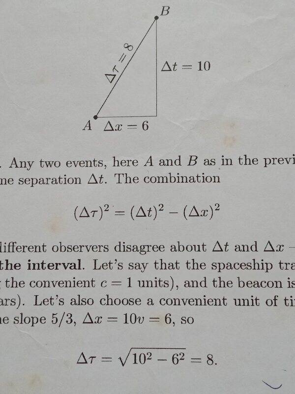

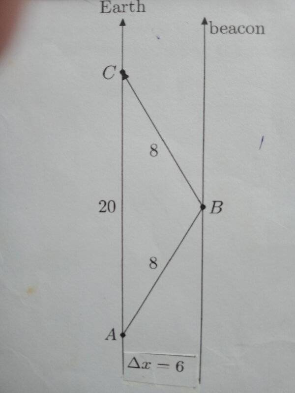

The moving clock is not ticking slower. The "time between ticks" or the mechanism action is exactly same to stationary clock. The elapsed time on traveling clock is less since it traveled less distance in spacetime. See diagram of space time interval. So stationary clock elapsed time is 10 and traveling 8View attachment 271974
It looks like you have transposed hypotenuse and opposite side! The hypotenuse cannot be shorter than the other two sides.
In Euclidean geometry you would be correct. But this is Minkowski geometry - a straight line is the longest distance between two points.
