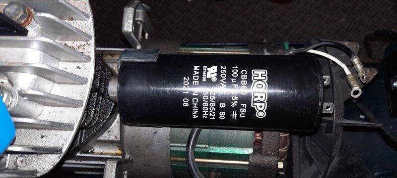

I recently purchased a capacitor for my air compressor but the terminals are not marked by any means , i have never seen that before can anyone tell me what i should do ? Does it matter ?
I think is is a bi-polar type intended for AC, so polarity does not matter.

It is a 250 VAC capacitor. It is 100 uF. It has symmetrical construction because it is for use in an AC circuit. It is not polarised and can be connected either way.
It could be the start or run capacitor for a single phase AC induction motor.
Is that the original or a replacement capacitor ?
What was the voltage rating and capacitance of the original capacitor ?
What is your supply voltage closest to; 115 VAC or 230 VAC ?
What is the HP or kW rating of the motor ?
Is there another capacitor on the motor, what specs ?

To the OP: Your capacitor is clearly marked 250 VAC. That is the correct rating for a capacitor intended for use in a 120 volt AC application, such as a motor start or motor run capacitor. Posts #2 and #4 are correct.

A motor START capacitor will be rated at close to the motor voltage. A motor RUN capacitor needs to be rated for about 1.8 times the motor voltage.

The quick way to identify a run cap is from the higher voltage rating. I believe it is because with varying loads, the run capacitor can react with the winding inductance to generate higher voltages in the series circuit.

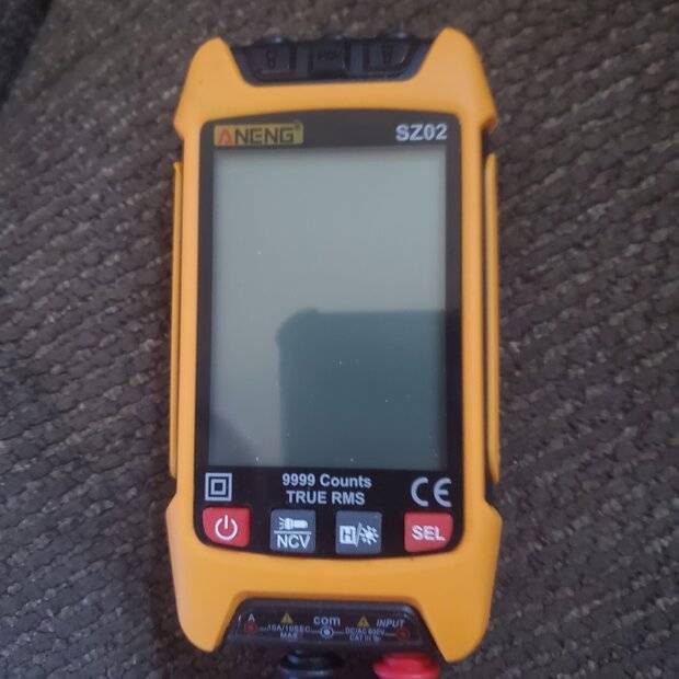

Tell us about your multimeter. I assume it has a capacitance measuring function? How much difference? What kind of capacitor?

This is the multimeter I used. Yes, it has capacitance and it's auto sensing. I haven't used it a whole lot so I don't know how accurate it is in reality but I have no reason to mistrust it anymore than anything else coming from Asia.
