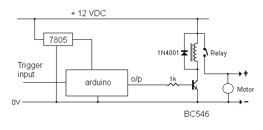

here's a very simple example from every day electronics
The Arduino micro controller doesn't have the capability of switching high current loads
so we use it to switch a transistor on that in turn turns on a relay and allows the larger current required by the motor to flowDave
