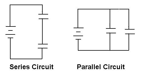

It says that the capacitors are in parallel, but why? I can´t understand this point, and it certainly seems as if they are in series
they are only in parallel if both switches S1 and S2 are closed, else the capacitor on the right plays no part in the circuit
this wouldn't matter if they were resistors, capacitors, inductors or many other componentsDave

Ah, until I saw the referenced diagram, I thought it might be down to 'Equivalent Series Resistance', which is frequency-dependent...
The "Equivalent Series Resistance" is zero in this case, independent of frequency, which shows the nonsensical nature of the problem, as posed initially. The final condition of the circuit is independent of any resistance and just hangs on Charge Conservation. You calculate the two charges (they have different signs, however you choose to take the origin) and the net charge will be shared between the two capacitors, which will have the same PD across them. The 3μF capacitor will have three times the charge of the 1μF capacitor.
