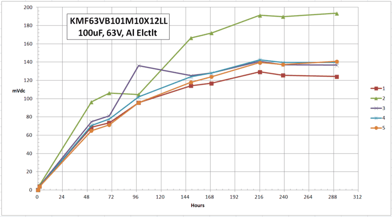

I was interested enough to try this myself with 5 very old 100uF, 63V Al caps; in storage for at least 10 years. They were tested OK for capacitance and df and shorted for a day. Here's what I saw:

All 5 level off after about 200 hours. Number 2 is from a different production batch, maybe?
Are you going to repeat the measurements to see whether they reach the same voltages again?
