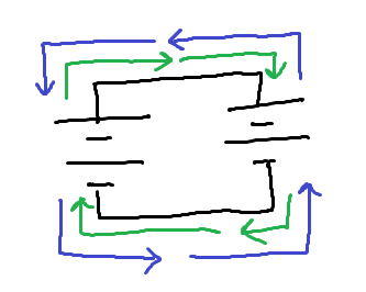

If you put two non-ideal batteries in parallel, a circulating current will be produced that tends to make the two sources equalize in voltage. Consider a 12v battery in parallel with a 6v battery. The internal resistances of the sources and the resistance of the connections determine the magnitude of the current. If you consider the resistance of the connection to be zero, then the voltage of the two sources will be forced to the same intermediate value.
It sounds like you forgot that a voltage is a difference in potential between two points; not one. By analogy, consider 1 foot high milking stools. Three stools on top of each other (series connection) allow you to step up three feet. Three stools on the floor (parallel) allow three times as much weight to be lifted one foot.
If you put two non-ideal batteries in parallel, a circulating current will be produced that tends to make the two sources equalize in voltage. Consider a12v battery in parallel with a 6v battery. The internal resistances of the sources and the resistance of the connections determine the magnitude of the current. If you consider the resistance of the connection to be zero, then the voltage of the two sources will be forced to the same intermediate value.
actually i hadn't considered this scenario. but, glad it was brought up.
the green represents the electric field emitted by the left battery. the blue, by the right. and so when their fields equalize the potential = 0.
This agrees with my intuition. so i really get it.

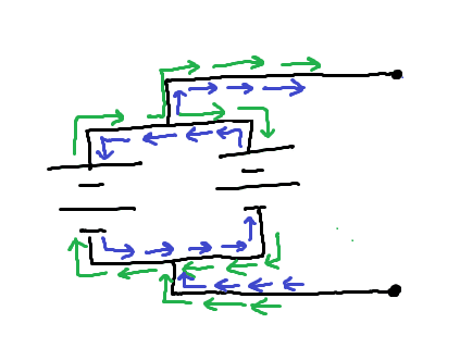

But here's where I'm having a hard time. If i attach wires to the top and bottom, this is what i have pictured in my mind as far as what goes on. i know i have something wrong, i just don't know what.
so now you can understand why i see the two fields adding at the junction point
Your arrows are depicting the currents, not the voltages. Yes, opposing currents superimpose and can cancel or add.
no not current nor voltage. i get how the current ends up going that route, but i was depicting the electric field.
first of all, is my first picture correct in depicting the E-field?
what about my second picture? if i have the wrong idea about the junction, why's the incorrect?
You seem to have current and voltage mixed up. Forget the word field, that doesn't help in cases like this.
I hate water analogies, but in this case it mighthelp. Imagine the wires to be like canals that connect water basins at unequal heights. The heights are analogous to voltage potential and the flow in the canals are analogous to electric current. Of course the heights and flows are related (water flows downhill) but they are not the same.

i do not have voltage and current mixed up.(a ended up writing a lot but i can save you some time; basically i want to understand what's going on at the junction from a fundamental standpoint. and from such a standpoint, you can't explain current without even mentioning the electric field)
for cases like this the only time the field does not need mentioning is when "voltage stays the same in parallel" applies. i don't see how this principle applies here which is why I'm trying to fall back on a more fundamental quantity

voltage stays the same in parallel yes. but this isn't "just because." do correct me if I'm wrong ---> but i can reason that (in a circuit with a voltage source and say.. two resistors in parallel) potential stays the same in parallel because the electric field essentially splits at the parallel junction. and this splitting doesn't have any effect on the field itself (which is where the potential comes from!) and that's why potential stays the same in parallel.
my original question deals with a case where there are two independent fields entering a junction.
