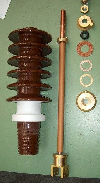

The leads on giant capacitors have always looked mysterious and complicated to me. They almost look like RF cavities to me.
Why are the bushings the shape they are?

This looks more like a giant HV insulator. The wavy shape (without sharp corners) is to maximize surface path length and minimize surface leakage, corona, and eventual arcing from exposure to year-round weather conditions, dust, air pollution etc.

Thanks, that makes sense. Is your remark "without sharp corners" there to minimize electric field from concentrating in one area?
Is the surface path maximization there to increase surface resistance?
Are these brushing the same things I see on power lines and at power stations some times?
Basically it's a hollow insulator with the capacitive coupling device inside.
Observe it'll shed rain like a leaf. There will remain dry places on underside of the "rings" to maintain insulation.
Near the ocean they get salt buildup. On foggy mornings you can hear them "sizzle". Electric company has periodically to shut down such lines and wash the insulators, unless Mother Nature provides a cleansing rain..

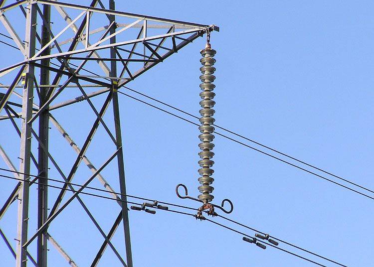

I use to be able to tell what a transmission line voltage is by the length of their insulators.

Photo of a high-voltage transmission tower with a tall stack of ribbed porcelain insulator discs hanging from the cross arm, with conductor cables attached to clamps at its lower end, against a clear blue sky.
I'm confused of what the purpose of that one in the picture is even for. Is it just to hang the conductors from the tower?
Yes, hanging the conductors. I probably shouldn't have posted causing confusion.

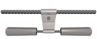

The little 'dumbell' things hanging from wire adjacent insulator are interesting.
I once asked our relay folks about them. They're mechanical dampers to prevent the cables "singing" in the wind like guitar strings which fatigues them. They are tuned to line's expected mechanical frequency and i think 1/4 wavelength from insulator. They're a bundle of wires clamped loosely together so as to have friction .
Exactly analogous to a tuning stub on electrical transmission line. no pun intended.

Getting a little off topic, albeit we're talking HV, they are called Stockbridge dampers.
Stockbridge damper on an overhead conductor cable: a central metal clamp with a bolt and two cylindrical weighted masses hanging from short cable sections on either side.
They have those dampers on the vertical wires on some (old design) suspension bridges, too.
