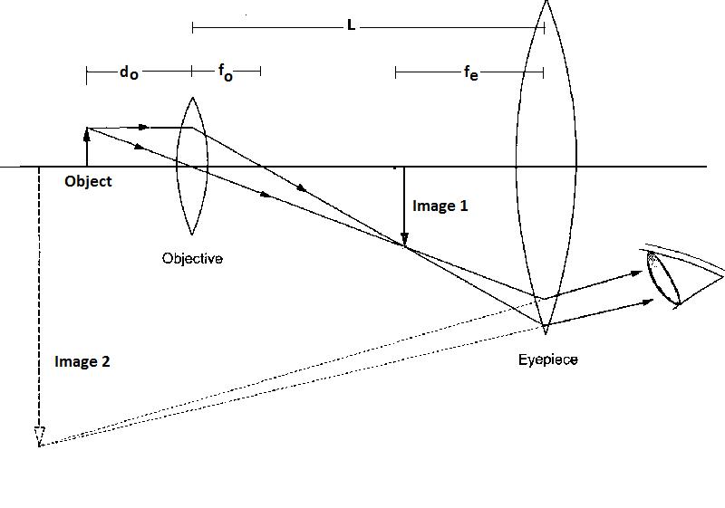

Alright. Below is an diagram of a basic microscope. The light from a single point on the object (in this case the tip of the arrow and only the tip of the arrow) is shown. That last bit is important. Light emitted/reflected from another point on the object, for example the middle of the arrow, would undergo a different path through the optical system but would still emerge from the eyepiece as a near-parallel bundle of rays like the cone of light shown. Note that the placement of the eye is actually incorrect here. The pupil would be placed on the right side of the eyepiece and would be much larger to catch all of the bundles of light emerging from the eyepiece, not just the single bundle shown.
Once the bundle of rays passes into the eye, the cornea and lens focuses the bundle down to a point on the retina. If the bundle is not focused to a point then you wind up with a blurry image.

So magnification is going to be the image created at the focal point, but it's possible to create a lens that bends light at super high angles so that maybe only 1 inch away from the lens, you can get a very high magnification? And likewise, it is possible to create a lens that bends light at very low angles to create an image that is same height as the object at a focal point very far away from the lens?
But I now have 3 questions:
1) I now understand that the reason why Image 1 is larger than Object is because the largest Y coordinate where the focal point is results in a larger height of Image 1 than the height of Object. But why does the eye see a much larger image (image 2), than image 1? Can you draw a diagram where the eyes are replaced with lenses?
I'm afraid I can't draw a diagram, nor can I find a good image. The reason the eye sees a larger image is because the rays enter the eye at a larger angle and get focused down onto the retina further from the center than they otherwise would be. Unfortunately I don't think I can describe it much better than that.
Visual instruments such as magnifiers and microscopes work by increasing the angle that the final image makes at the eye compared to the angle that the original object makes at the eye - they provide angular magnification. In these two instruments, the final image is virtual i.e. the rays diverge as they leave the instrument, as in Drakkith's diagram. (I would have drawn that with the eye centered on the optical axis).
