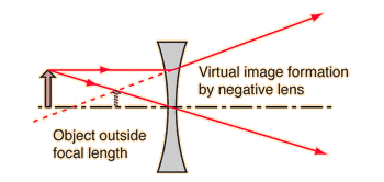

Thanks for the details and it helps me to clarify a lot but I have seen image formation concluded where two rays merge after converging - the third ray might not even converge at the same point : http://hyperphysics.phy-astr.gsu.edu/hbase/geoopt/image2.html#c2
Here you can see if we consider the 3rd day : "a ray through the near focal point will emerge parallel to the optic axis on the far side." will never converge where the other 2 rays did - so how do I know which 2 rays to consider first and when should the 3rd ray not be take for image formation - is there a rule for same?

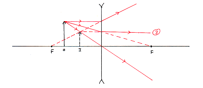

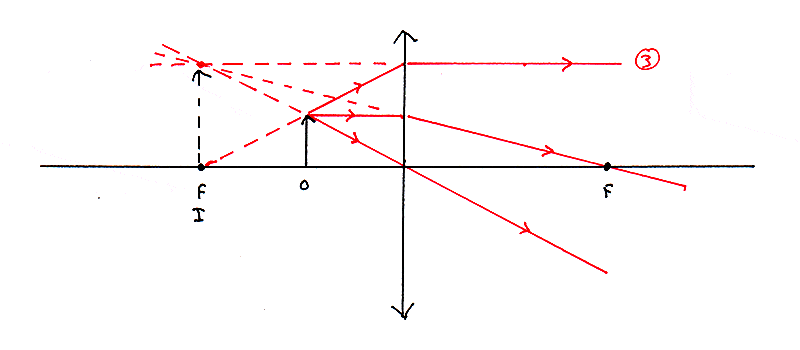

Any two of the three "principal rays" are sufficient to locate the image, provided that you draw them correctly.
It is useful to draw the third ray also, to serve as a check on the other two.
When drawn properly, your third ray does indeed "pass through" the location where the other two rays meet. You need to extend the ray backwards from the lens, along the line that it follows after passing through the lens.
Converging lens:
(The diagram above happens to have the image at the left focal point, because the object is exactly halfway between that focal point and the lens.)
Diverging lens:
