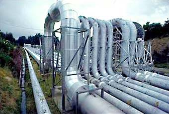

Long steam pipes often have a section in the shape of a \bigcup. Why?
None.
I'm at a loss. It might be because of some sort of volume expansion, but I'm not entirely sure why...

What do imagine this U-shaped section looks like? Describe it.
Um, probably a vertical "bump" in the pipe, like this:
Ah. An upside down U. Sorry. I assumed it was a right side up U.
I led you down the wrong path then. Apologies.
You were closer to the mark with your guess. But it is not volume expansion. Ever walked a large bridge? Ever notice the bridge is cut into sections, with with rubber sandwiched between them?
Ohhh, I think it's for allowing expansion so there's not that much stress because when expanding with the U-shaped curve then the pipe would get closer together across the empty space between the ends of the curve. Thank you so much! What would be the purpose of an right-side up U then? I would imagine that it's the same but from what you said it seems it does not serve the same purpose.

In a pipe that passes steam (such as my dryer vent), you would want a section that is lower than any other part of the pipe, with a drainage valve at that point for condensation.
