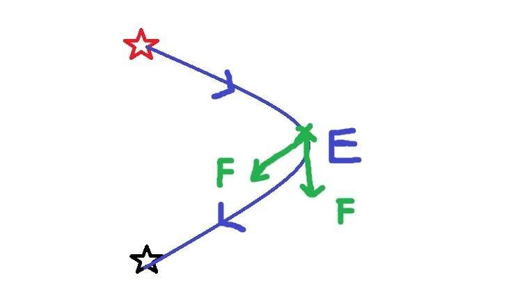

oh but why is the force supposed to be tangential to the e-field at that point?
for example in this diagram, the force on the green + charge, shouldn't it be towards the - black charge?
why is the force tangential instead to the e-field?
Hand-drawn sketch of a curved blue field line running from a red star at upper left to a black star at lower left, with a point marked E on the curve and two green arrows labelled F drawn from that point.
By definition, the direction of the electric field is the direction of the electric force on a positively charged particle. In vector form,
[tex]\vec F_e = q \vec E[/tex]

If the vertical components of the two forces exactly balance each other, then the dipole will remain oriented as it is. However, this is an unstable equilibrium. If the dipole is even a tiny bit misaligned from the vertical, or if the field lines are not precisely circular arcs, then the dipole will start to rotate towards the opposite orientation, while moving to the right as previously noted.
Exercise: when the dipole has reversed its orientation, what is the direction of the net force now?

net force to the left? assuming the vertical components of the +ve(towards bottom) and the -ve(towards top) cancel out?
i just have to follow the E-field lines right? like you mentioned earlier
"By definition, the direction of the electric field is the direction of the electric force on a positively charged particle. "
