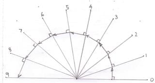

In the right case (not exactly that path curvature), after an initial impulse the door rotates too slow, so the force from the door flips direction, and since it is already rotated, this normal force has a component to the right.
We said that right case is not possible.
Bottle cant shift to the right from original position, to do that we must have some real outward force..
  • #62
No, that is not the case. What makes your right picture unphysical is that it starts with the bottle moving outwards. Were you to simply stop the door’s rotation, the bottle would retain its radial velocity and eventually pass the vertical line.
  • #63
The final horizontal offset to the right is possible, but the path should start vertically and then deviate to the right. The force to the right comes from the normal force by the door which has already rotated, but is now too slow, to create the force free case on the left.
  • #64
Or start down, deviate to the left, then turn to the right. It all depends on exactly how the door opens.

Here is my two bits of wisdom while summarizing much of what has already been said.
First the theory. For an object following a curved trajectory the radial component of the acceleration is $$a_r=\ddot r-r\dot{\theta}^2.$$Here we assume that (a) there is no force in the radial direction and (b) ##\dot{\theta}=\rm{const.}=\omega.## Then the radial acceleration ##a_r## is zero which means that $$\frac{d^2r}{dt^2}=\omega^2r.$$One might interpret this as saying that the rate of change of the radial velocity is equal to the centrifugal acceleration. Regardless of interpretation, the solution of this equation is $$r(t)=r_0\cosh(\omega t)\implies r(\theta)=r_0\cosh(\theta).$$ Shown below is a parametric plot of ##y=r(\theta)\sin(\theta)## vs. ##x=r(\theta)\cos(\theta)## in equal 10° increments of ##\theta.## The hinge of the door is at the origin and the door opens counterclockwise towards the y-axis. The length units are arbitrary but have an aspect ratio of 1 on the screen.
Note that from 0° to about 30° there is practically no displacement in the x-direction which is the initial orientation of the door. This is because there is practically no force in the x-direction until the normal force rotates enough to provide a significant component in the x-direction through the normal force. A Taylor series expansion for the horizontal position of the mass yields $$x=r_0\cosh(\theta)\cos(\theta)=r_0\left[1-\frac{\theta^4}{6}+\mathcal{O}(\theta^6)\right].$$ This small angle approximation is what I attempted to illustrate in post #13 albeit more crudely. Finally, it should be clear that the shape of this curve is independent of the constant ##\omega##.

No, I'm assuming no friction so the glass is free to move along the door. The normal forces, which keep the glass within the fridge door shelf, can act form either side (railing and door itself). Once the door is rotated, and the normal force comes force from the door (because it opens too slowly for the already moving glass), it has a component to the right (in the diagram of post #15).
Normal force dont have component to the right when door opens constantly or accelerate(increase door rpm).
It has component to the right only when door decelerate(rpm slows down)
