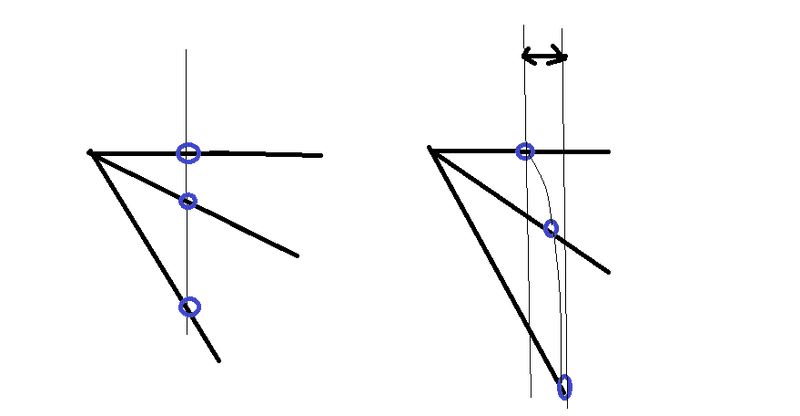

Orodruin said:
No, it isn’t. For several reasons. Nor is the left picture except in very particular cases.Consider the closed door starting to open. This gives a force perpendicular to the door, which starts putting the glass into motion downwards in your picture. At the insrant of opening downwards will be tangential and not radial. The glass will continue the induced downward motion unless acted upon by another force. However, as the door swings open by even a minor angle. This means that downwards is no longer purely tangential, it has a radial component. Hence, the glass now has a radial component of velocity without ever being acted upon by a radial force.
Why right case is not correct and is left case possible in reality?
You drew that image using the inertial reference frame where centrifugal force is zero. So the bottle cannot move to the right; there are no forces in that direction. Thus the right hand diagram is wrong.
The left hand diagram is possible if there is zero friction between the door tray and the bottle and the door tray is very wide. The bottle gets an initial downward impulse from the door and then skates frictionlessly downwards.
In practice that's not possible, and the bottle path will curve slightly to the left due to friction and bumping into the door.

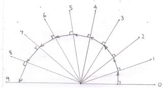

Bottle will curve to the left like this, so acceleration is inward?
1.If I stop door rotation in time t2 and if door end is open, then bottle will leave door in radial direction vr?
2.If bottle leave door(open end) when door is still rotating, it will leave door with tangential direction?
The acceleration is to the left. I wouldn't characterise it as radial.
It'll bump into the door or the railing of the shelf it's on and bounce off, or it may already be sliding along the railing. The result of the force from the railing will be to push the bottle outwards, yes.
Depends on a lot of details of the experiment. In the idealised case shown in your original left hand diagram, no it'll go straight down. If the bottle is small compared to the width of the door and it's sliding along the door rather than skating along frictionlessly, then it'll be tangential, yes.

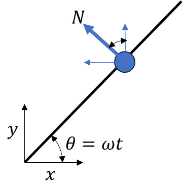

Ok, let's do the calculation for an idealized model: A bead is gliding along a rigid rod, which is rotating at constant angular speed. Let ##(r,\varphi)## be the usual polar coordinates. Then the position vector of the bead is
$$\vec{r}=\begin{pmatrix} r \cos(\omega t) \\ r \sin(\omega t) \end{pmatrix}.$$
The velocity is
$$\dot{\vec{r}} = \dot{r} \begin{pmatrix} \cos(\omega t) \\ \sin(\omega t) \end{pmatrix} + \omega r \begin{pmatrix} -\sin(\omega t) \\ \cos(\omega t) \end{pmatrix}.$$
Lagrangian is
$$L=T=\frac{m}{2} \dot{\vec{r}}^2 = \frac{m}{2} (\dot{r}^2 + \omega^2 r^2).$$
The equation of motion is given by the Euler-Lagrange equation,
$$\frac{\mathrm{d}}{\mathrm{d} t} \frac{\partial L}{\partial \dot{r}}=\frac{\partial L}{\partial r},$$
i.e.,
$$m \ddot{r} = m \omega^2 r \; \Rightarrow \; r(t)=A \cosh(\omega t) + B \sinh(\omega t),$$
i.e., the bead is flying radially out.

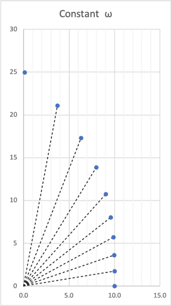

Of note is that the x-coordinate of this solution (assuming ##\dot r(0)=0## is given by
x(t) = x_0 \cos(\omega t) \cosh(\omega t).
Here is a plot with ##\omega t## on the horizontal and ##x(t)/x_0## on the vertical axis:
Note how the value of ##x(t)## never exceeds ##x_0##.
(Obviously this is assuming an infinitely long door. In the case of a finite door this plot will stop being valid when the glass reaches the end of the door.)

That can be tricky to visualise until you look at the forces in polar coordinates.

user079622 said:
right case is correct.
It depends on how you vary the angular velocity of the door.
In the left case, after an initial impulse the door rotates such that it doesn't exert any force on the glass.
In the right case (not exactly that path curvature), after an initial impulse the door rotates too slow, so the force from the door flips direction, and since it is already rotated, this normal force has a component to the right.
