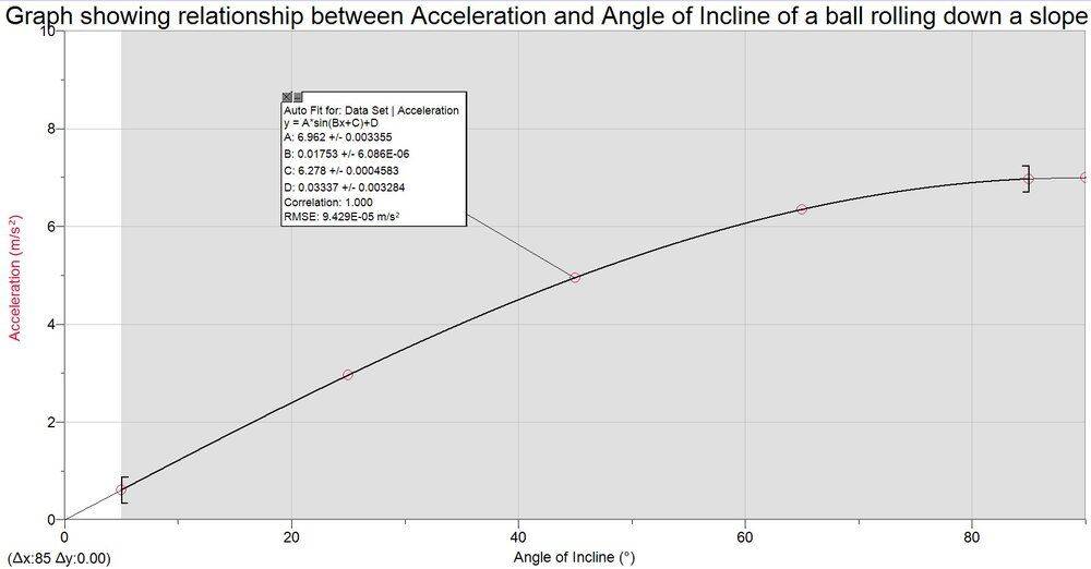

why does acceleration of a solid sphere increase by less as the angle of incline increases?
a = 5mgsin𝛳/7
This is true considering the rotational inertia of a solid sphere is (2/5)mr^2
My only guess is that this is due to air resistance. Below an example of the predicted graph:
Well, why don't you work out ##\frac{da}{d\theta}## and see how then consider how the gradient varies with ##\theta##?

That's interesting. I am not using a v-shaped track, just a flat ramp. I'm new to this platform, where can I find the thread?
It's a derivative! Are you familiar with calculus, and do you know how to find the derivative of ##\sin{\theta}## with respect to ##\theta##?

I'm afraid I have gone too far down a rabbit hole. I could work it out for each angle and plot it on a graph and find the slope but I'm not sure how to do so otherwise.
Okay. What you would have ended up with is$$a = \frac{5}{7}g\sin{\theta} \implies \frac{da}{d\theta} = \frac{5}{7} g \cos{\theta}$$Here ##\frac{da}{d\theta}## is the rate of change of ##a## w.r.t ##\theta##, i.e. the gradient of the graph you posted. Notice that as ##\theta## gets closer to ##90^o##, ##\cos{\theta}## get closer to zero, i.e. the gradient gets smaller and your curve gets flatter and flatter! This is the more precise way of saying that "equal increments in ##\theta## give diminishing returns in ##a## as ##\theta## gets larger".

I can see that but is there an explanation behind why the ball accelerates by less at the same increments for greater angles like increased air resistance or friction or is this just a given and we don’t know?
Not really. That expression for acceleration is derived by considering friction, but that only really changes the leading coefficient of the term and not the general form of ##\alpha g \cos{\theta}##.

Consider the acceleration of a block of mass, ##m##, sliding down an inclined plane (angle θ w.r.t. the horizontal).
The graph of acceleration vs. angle of inclination looks very much like yours.
Jojo-11 said:
Homework Statement:: why does acceleration of a solid sphere increase by less as the angle of incline increases?
a = 5mgsin𝛳/7
The answer is right there in your equation: sin(θ), not θ.
What does a graph of y=sin(x) look like?
