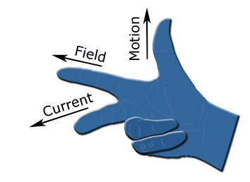

I know that the right hand rule applies for induced currents, and the left hand rule is for motors, but why? It doesn't seem to connect with any other physics laws and is very counter-intuitive that the current will flow in one direction rather than the opposite direction if both are perpendicular to the path of motion and electric field, and the electric fields are symmetrical lengthwise.
Fleming's right hand rule shows that if you have a force in a certain direction and a magnetic field to in another direction, current will flow in a direction perpendicular to both. If you had a motion upwards, and a field to the left, current would flow towards you. but why not away from you? If it flows away from you it would still be perpendicular to both motion and magnetic field, so what makes it flow towards you instead of away from you?
I am looking for a physical explanation more than a mathematical one.
This is a simple matter of convention. We arbitrarily define the direction of the magnetic field to point in the direction that the right hand rule works. We could have arbitrarily chosen to use a left hand rule instead. Then the direction for the field would be chosen with the opposite sense such that a left hand rule would work.

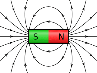

Okay, but then current would still be choosing one path over the other, why does it move in one direction particularly? The magnetic field is symmetrical lengthwise so it seems that current would not travel in either direction because the forces causing it to move would cancel out due to the field being symmetrical
I am not exactly sure what you are asking here. If you simply put a loop of wire around a magnet then you are correct, there is no current flow. On the other hand, if you run current through a loop of wire around a magnet (e.g. drive the current with a battery), then there will be a force exerted on that loop of wire.

It looks like there is some confusion in the use of the words. In the picture, the thumb is showing something called motion. If that is the direction of the force on a current in a magnetic field, that picture is wrong, as sophiecentaur points out.
