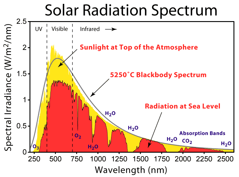

The link you gave only considers how much of each frequency is absorbed. It is also important how much is emitted. This link shows how much actually reaches sea level:
http://upload.wikimedia.org/wikipedia/commons/4/4c/Solar_Spectrum.png
There you see there is still a problem. Since the highest point in infrared is still lower than almost all of visible light. I can only guess at an explanation:
1. the thermometer absorbed infrared more than visible.
2. the prism absorbed visible more than infrared.
3. the thermometer happened to be near the ends of visible where the intensity falls lower than near infrared.
As I said, these are only guesses. I'll be interested to see if anyone else can provide a more certain answer.
Oh, so the small valley accounts for it having a higher temperature. Also, maybe the fact that it is more concentrated than the other light rays that are scattered makes it heat up the thermometer more than the green - violet light.

The irradiance in the visible portion of the spectrum is greater than for for IR:
From: http://en.wikipedia.org/wiki/Sunlight
But there are some holes due to filtering by the atmosphere. The prism might also have filtered more visible than IR light.

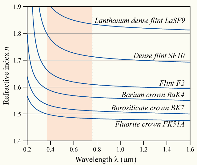

It should also be noted that the dispersion of light is not proportional to wavelength:
Visible range is orange. From: http://en.wikipedia.org/wiki/Dispersion_(optics)
So holding the thermometer into the IR area might capture a wider range of wavelengths, than within the visible and UV area (more surface under the first graph due to a wider wavelength range, despite lower irradiance).

I don't think the holes really matter. He placed the thermometer right after the end of the visible spectrum. So just before the O2 hole.
http://upload.wikimedia.org/wikipedia/commons/4/4c/Solar_Spectrum.png"
http://upload.wikimedia.org/wikipedia/commons/2/20/Dispersion-curve.png"
Yup, I was aware of the spectrum peaking in the visible, but as it seemed the OP's main confusion was about the energy-per-photon, I just wanted to clear that up. It seemed that nobody else was addressing that.
I thought about the lesser dispersion of n in the IR, and you bring up a good point that the transmission of the prism could have played a role. Another possibility is that the thermometer had a greater absorptivity for near-IR wavelengths -- effectively acting as a filter.
I think this is it.

The answer turns out to be the experimental design, and a failure to correct for refraction. In Herschel's setup, sunlight is refracted by a prism. The index of refraction of course must vary with wavelength so that the sunlight would be dispersed into its various colors. If the index of refraction varied linearly with wavelength, Herschel would not have needed to correct for that variation, since the wavelengths would be uniformly spaced along his table.
However, since the index of refraction varies non-linearly with wavelength, the wavelengths will not be uniformly spaced along Herschel's measuring table. The actual spacing of the wavelengths versus distance along his table for an incidence angle of 45° from air into glass shows that the infrared region is much more highly concentrated than optical wavelengths. (The plot shows the spacing along the spectrum divided by the distance from the prism. Hence to get the actual spacing in cm or inches, multiply by the distance from the prism in cm or inches.) The relative concentration factor is shown normalized to 0.60 micron.
The net result is that Herschel's observed "temperature" should then peak in the infrared. The energy vs. wavelength plot for the "45° glass" model given above shows that Herschel's observed "temperature" should keep increasing toward longer wavelengths. However, when properly corrected for the relation between wavelength and distance along his table, he should have finally published the "no wavelength concentration" curve shown in that plot!
A good referee should have caught this mistake.
