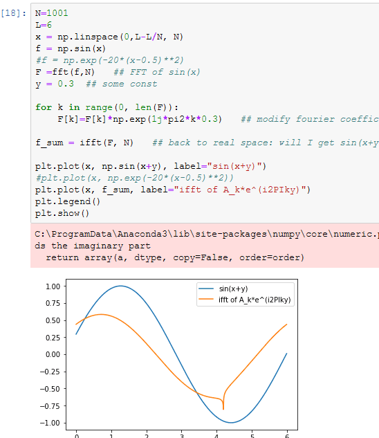

Hi guys,
for a project I had to get involved with discrete Fourier transforms to solve PDEs.
However, the code that I implemented according to a pseudo-code from a paper did not work - it seems like I calculated integrals incorrectly.
To search the error, I tried to integrate the sin(x) function with my method, and it did not work.
I already posted the formula I used for this sine integration, as well as the code, here:
https://scicomp.stackexchange.com/questions/33886/calculate-integrals-using-numpy-fft
Does anyone know what I am doing wrong? The error does not depend on N, and after my inverse FT my signal contains nonzero imaginary parts which should not happen! Is there something wrong with my formula?
I am a bit desperate, since my deadlines are getting closer...
SL

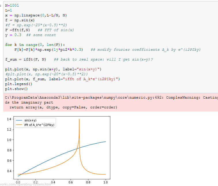

I would not know how. The deviation I am seeing is independent of number of data points N. Moreover, my final vector after the inverse transform has nonzero imaginary parts which should be impossible when I take the FFT of a purely real signal. To me, it looks like there is an error in my theoretical formula.
I expand the function in a Fourier series under the integral and truncate it for ##|k|>m##. In my code, I only know the function on ##2m+1## discrete data points and I try to calculate the ##A_k##, i.e. the coefficients of the Fourier series, via a FFT. Maybe there is something wrong with this approach?
You might have forgotten to multiply by the last ##e^{2piky}## term in your loop.
But why would I need these? They are simply the usual exponentials of the inverse transform, they do not belong to the amplitudes that are given by ifft.

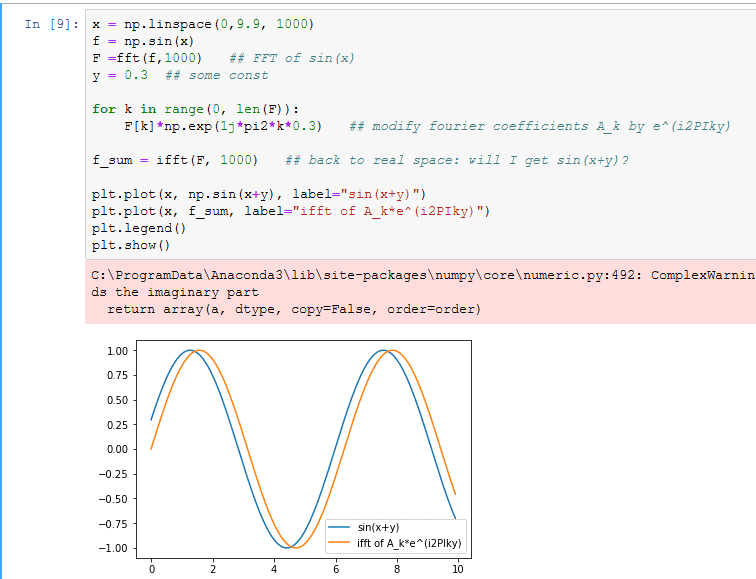

I think I found the mistake.
If I know the discrete Fourier transform, i.e. $$ A_k =\sum_{i=-N}^{N} f(x_i)\cdot e^{-i2\pi x_i k}$$ and I write $$ f(x_i)=\sum_{k=-N}^{N} A_k\cdot e^{i2\pi x_i k},$$ then it does not follow that
$$f(x_i+y)=\sum_{k=-N}^{N} A_k\cdot e^{i2\pi (x_i+y) k}.$$
I tested this with a small code:
This would explain why I have not found this kind of integration online :D
What do you think?
